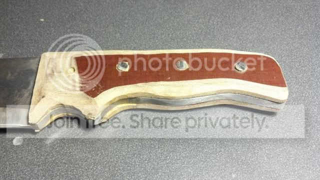

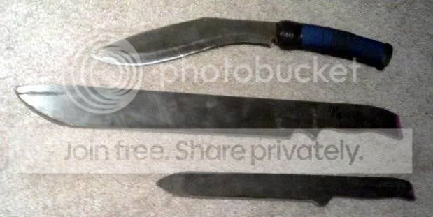

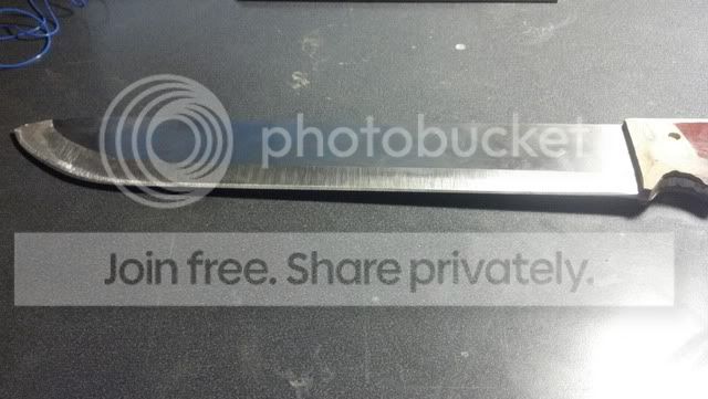

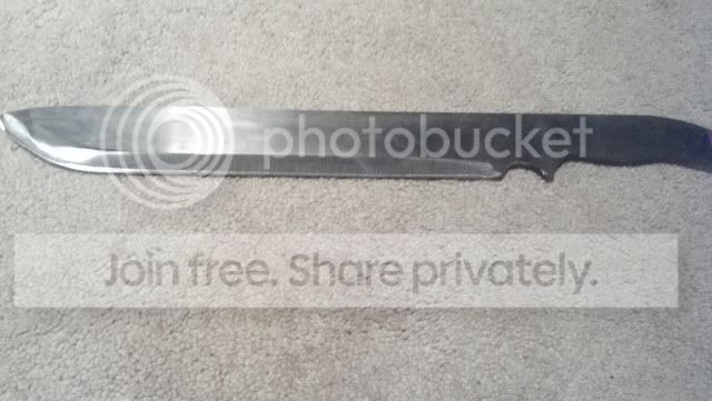

Hey guys! A couple weeks ago I started work on a ridiculous chopper knife, and I'm finally reaching a stage where it looks like the knife I envisioned in my head. I figured I'd should a few WIP pics, and see if I can get a little help with a small issue I'm having.
This is the shaped knife blank in the middle, next to a kukri and another knife I'm working on for scale.
Then there's the blade with a bevel more or less finished up
And the knife with some rough scales temporarily pinned on.
My question is this; how would you guys suggest smoothing out the inside of that finger choil? The curve is a bit too steep to get in there with my belt sander...
If you don't have a small wheel arm/tip for your grinder, you now know why one is a good idea.
A spindle sander also does good in these places.
The great thing about a socket set is you probably have one that will just about fit that curve perfect.
Edit: missed your post the first time around gredpe3, socket does work like a charm though.
