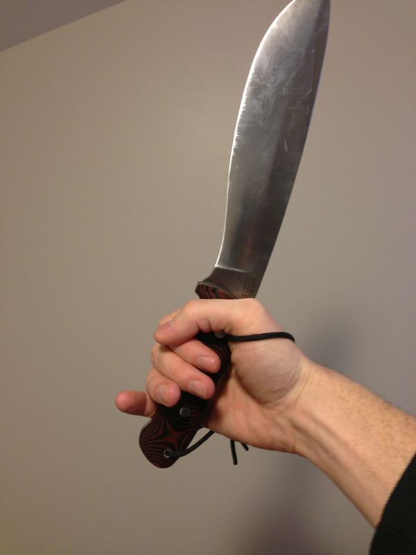

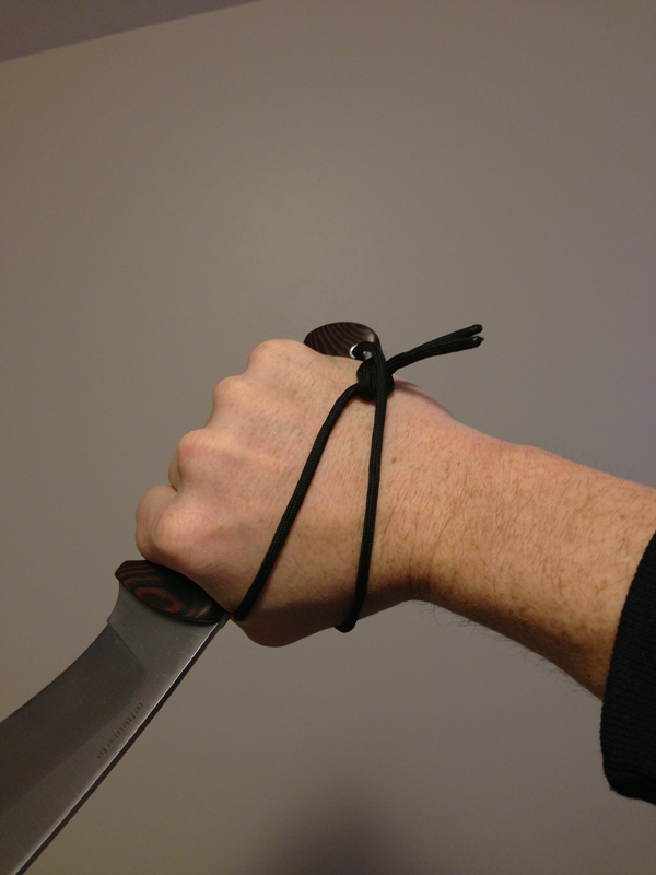

At this point, I wrap the chord around my hand. However, as you can see the lanyard inhibits a full backwards rocking motion of the knife/handle and that translates into reduced motion of the wrist unless the lanyard is loosened. When it's loosened, it becomes less secure. That's the trade off I'm looking into.

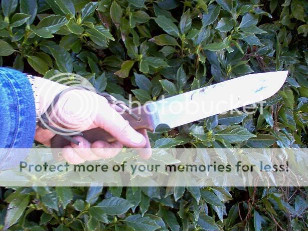

This is one example, there are a couple different ways to "wrap" the lanyard around/over your hand:
It's important that it not be too tight, as obviously that will restrict movement of your wrist and be uncomfortable. The chief advantages are that A) if for some reason you let go of the knife, it can't swing under/around and cut you - it will stay right where you can easily wrap your fingers around the handle again; as I understand it a famous maker/cutter (I want to say Warren Osbourne, but I can't swear to it) sliced open his forearm badly when a rear-mounted-lanyard knife slipped from his grasp and swung back under his arm. He subsequently encouraged front lanyards... and B) it allows for a slightly relaxed, but secure grip on non-cutting motions. For a comp cutter who works in bursts of several seconds or a couple minutes, that's not a big deal. For a guy clearing a campsite or yard, it can make a big difference.
Honestly, I would rather have no lanyard at all and risk sending my knife flying into the woods than use a lanyard like that. If that bad boy slips, you have a very large, very sharp blade moving very quickly, and it has nowhere to go except right back into you.
Yea. If one let go of the blade, that particular lanyard wrap seems like it would facilitate knife travel towards a user.
It's important that it not be too tight, as obviously that will restrict movement of your wrist and be uncomfortable. The chief advantages are that A) if for some reason you let go of the knife, it can't swing under/around and cut you - it will stay right where you can easily wrap your fingers around the handle again...
At this point I totally buy your argument. I think I now understand one reason why Siegle typically uses all tubes on his choppers; the tube located closest to the ricasso can be used as a forward positioned lanyard hole.
...the tube located closest to the ricasso can be used as a forward positioned lanyard hole.
Yup, that's become very popular and it's a fine idea. Incidentally, that picture I posted is a Scott Gossman knife, originally posted by him in a similar discussion.

The knives you and Alfred have both shown, as well as the Gossman example, have much better handle designs, with more thickness/width at the back, which makes them much easier to "lock" into your hand. :thumbup:
