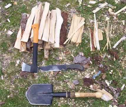

The Cold Steel Shovel is fairly heavy at 770 grams and balances 8" infront of the index finger on a full grip and most of the weight is concentrated in the head so it is very powerful on a swing. The initial edges are rough and thick, I reduced the ones on this one to about 0.070" and 22 (1) degrees per side. They can be lower of course, but since it is a shovel and it does hit rocks, I left it fairly obtuse to keep from getting too tore up :
I have had it for years and use it a fair amount, most for rough work. I recently benchmarked it on spruce 2x4's to check the chopping ability in some detail. I ran it against a Ratweiler :
and the saw of a Rucksack :

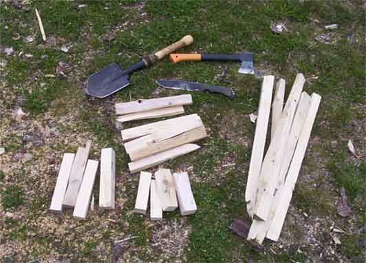

Twenty pieces of 2x4 were cut, the times were 39 (7), 14.7 (6) and 21 (1) for the shovel, Ratweiler and saw respectively. This gives a relative rank of 4,10, 7. Thw shovel hits hard, much more powerful than the knife, but it binds really bad and a lot of time is wasted in hauling it out. Plus it has little to no chip clearing ability so the performance would get even worse on larger woods.
The time for the knife is in general low for its ability as I don't do a lot of speed chopping, I would never chop this fast actually working, the fatigue rate is too high, considering the number of wasted hits I would not be surprised if the wood could be cleared in half that time with someone with better precision (and more powerful always helps) speed chopping.
The saw stands out from a performance/weight perspective on this type of wood, but the performance really starts to suffer on other tasks like limbing, or thicker wood and especially sheets of lumber as noted previously. But for just sectioning small-medium sticks it does really well for its size.
