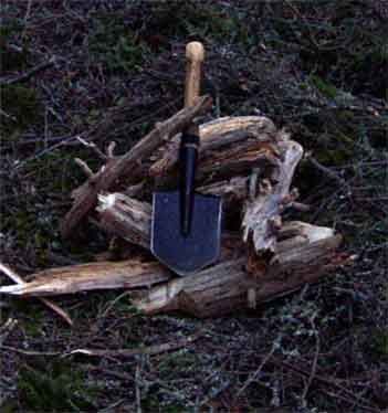

That dead stuff is rock hard, when you chop into it the shovel makes a loud ring. I smashed off the limbs chopping at full force, this is really abusive cutting for an optimized wood cutting blade but even though this shovel is regound heavily the edges are still 0.050" thick and far more obtuse than I run wood cutters. It had no problems removing the limbs and took them all off in one swing each. I then bucked up a dozen sections :
The performance was *much* better, it was no longer outclassed by the Ratweiler. The higher penetration also reduced feedback and it was much more comfortable in hand. After the cutting it had no significant difference in sharpness and could still slice paper readily. I'll do some digging tomorrow comparing the times against the Ratweiler on some types of ground and check edge durability. I'll also resharpen to proper push cutting sharpness to allow a sensible edge retention comparison on woods as I am curious how much wood work you can do with it before you can't cut fine vegetation for example.

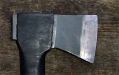

A top down shot of the Fiskars head after modification :
note the primary grind goes pretty much straight to the edge. A shot from the side :
The edge bevel is massively wider than the origional one as noted to blend it back into the primary, however the main influence on the cutting ability was the removal of the secondary edge bevel and the reshaping of the last 1/8" of the edge bevel.

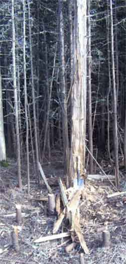

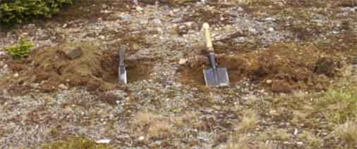

As a side note on wood working, I did find an area where the shovel did outperform both axes and blades. If you chop it into a tree leading with the secondary point or primary, you can lead on its sideways and pry off large sections of dead wood. It basically combines the front penetration of the axe with the prying ability of the knife :
I did some digging with the reduced edge profile, I had in fact reduced it further to around 28/30 degrees included. There was no problem digging a hole in rocky soil with no visible edge damage. The glances off of rocks will blunt the edge significantly, but the damage is focused on the leading edge and not the sides :

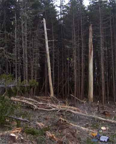

I have done some felling (250 chops on small sapling) and limbing out a couple of dozen small sticks and the edge will still readily slice photocopy paper, so while it isn't on par with a decent high end knife, it isn't like you cut a few pieces of wood and can't do any fine cutting either. As noted though it takes a lot of metal removal do get the shovel to this stage, this is now close to have the angle of the origional profile.
It handles now similar to a wide bladed machete/axe, the only problem remaining is that since the edge is curved it tends to want to rotate in the cuts so you have to adjust your entry angle to compensate. It does tend to make me want to get a decent small double bit axe now, until I have to split some kindling anyway which quickly reminds me why I never bought one.

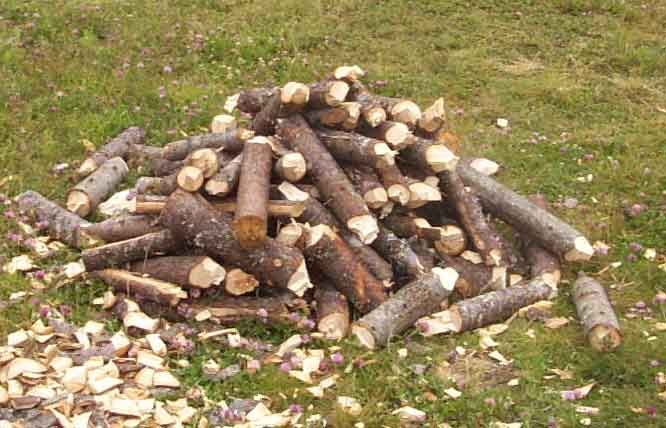

I have done a fair amount of bucking, felling and limbing with the Ratweiler and Cold Steel shovel, both with the modified profiles. Both are taken to the extremes in terms of edge angle. The Ratweiler can't go any further because if it does it will ripple on small diameter hardwoods and the Shovel is as low as it can go because it is flat to the sander at its current profile due to the curvature. Here is an example of one such comparison of the two blades :
With the optomized profiles the shovel is ahead of the Ratweiler, specifically 25 (5) % in terms of a chop count, and it is 45% heavier so it isn't efficient from a performance/weight perspective. Normally the chop ratio correlates well to penetration, but here the accuracy and precision was much lower for a number of reasons, plus the shovel tended to make curved cuts which also reduces its performance. The raw penetration was about double the chop ratio, so with much more practice I would expect the chop ratio to increase.
However the time ratio was low as there were issues with binding on some woods due to a combination of the flat sides and the curved cuts which are very problematic in wedging, especially on the first cuts. It wasn't unusual to have to work the shovel back and forth out of a cut so it was multiple seconds per impacts wheras the Ratweiler can actually run multiple impacts per second. However I did find the handle on the shovel to be more comfortable for long term use mainly due to vibration impacts on the Rat because when you move the grip back to get more power the ideal sweet spot impact moves back as well.
In terms of limbing the knife was generally far more effective than the shovel which was more like an axe than a knife and the curved blade also was problematic. However I would not say it was outclassed and it made up for it in felling because it was easier to get heavy power swings with the shovel on the waste relief cuts. Again though, be careful with heavy swings due to the tendancy to turn, you have to adjust the impact angle over a straight blade.
In short, with optimal regrinding you can turn the shovel into a very respectible wood working tool. Comparing it to the Wildlife hatchet it will be in the same class in regards to general power and penetration, though be much less fluid in thicker woods and far behind it in splitting power. The edge retention is solid, half that pile of wood in the above was bucked with the shovel and it readily sliced newsprint after the chopping. I can still readily dig with it in rocky ground with no significant damage to the side but for cutting roots and similar, to prevent against chops into rocks I would run a more obtuse secondary bevel on one side, similar to double bit axes.
