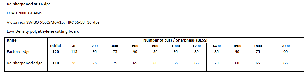

To see if it was something about the factory edge, I re-sharpened the knife used in our chopping board experiment at the same 16 dps, using our sharpening and deburring procedure for mainstream stainless steel knives. The edge angle was controlled with our computer software for Tormek, and verified with a laser protractor.
The only difference was that I started on #80 CBN wheel to remove the metal affected by factory sharpening, and then followed our standard procedure on CBN wheels #200, #400, #1000 and deburred as described on our website http://knifegrinders.com.au/06Procedures_SS.htm
The edge scored 80 BESS, so I had to bring it to the initial sharpness of the knives used in the experiment which was 120 BESS - I did it by rounding the apex by gently honing it on the rock-hard felt wheel with 1-micron diamonds on Tormek at 2.5 degree higher than the edge angle, till the edge started scoring the same as the knife in the experiment.

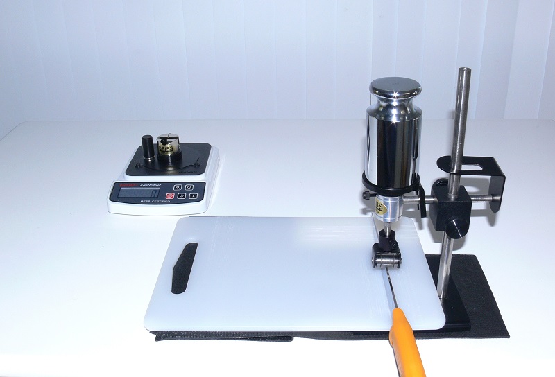

Then I tested the low-density polyethylene board the same way we did with the factory-sharpened knife.
If you ask me why i did not use the best edge-friendly high-density polypropylene board - I avoided extremes on purpose as I wanted to look further into the phenomenon of self-improved sharpness as such.

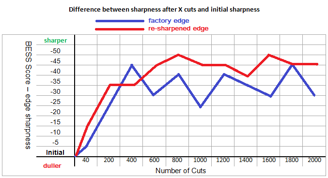

Following are the sharpness data and chart.
We see that the re-sharpened and cleanly deburred edge also gets sharper from slicing the chopping board due to this mystical phenomenon, and sharper than the factory edge.
We see that it is not plastic specific, and not about the burr.
I am still scratching my head for a plausible explanation of this phenomenon.
Comments are welcome.
Very interesting phenomenon.
My thoughts.
(1) It is still burr/wire edge removal.
(2) Plastic board cleaned smudge off from the edge.
(3) Plastic does refine the edge.
(4) It caused some micro chipping and increased the apparent sharpness, assuming that a coarse edge performs better than a polished edge on the tester.

The fact that the effect fully develops between 200 - 400 cuts, we may assume that #1 and #2 have role before that, and # 3 carries on.
But it is not only about plastic, as we saw somewhat similar effect on some wooden boards as well, though to a lesser degree, as detailed in the report. But true that the plastic effect is more pronounced and regular.
Can we think of an explanation for the "Plastic does refine the edge"?
It is clear that no abrasion happens when the plastic board is edge-friendly.
It could be a combination of a few causes.
I see the effect at 40 cuts (though "n" is only two), such that I would not eliminate #1 and #2 just because the effect persists.

We took measurements in the same point on the edge through the experiments.
When the edge is coarse, ragged, chipped - the sharpness tester readings are chaotic, the more polished the edge, the more uniform are the sharpness scores on the instrument.
I would not suggest chipping happens in the Victorinox s/s steel X50CrMoV15, for sure not under the test load of 2 kg.
Neither happens the edge rolling. Thanks to the test stand, lateral forces are way less than those perpendicular to the edge, preventing the edge rolling.
Those forces straight onto the edge do not cause the apex to mushroom or we would see worsening of the sharpness scores.

By the way, did you change the position of the board at each cut?
All boards were brand-new.
We kept changing the board position every 20 cuts through all the tests, ie after 20 cuts done in the same line on the board, the edge was moved to a fresh untouched board surface to continue there, and so on.

Were the cuts done as a sliding cut, or straight down chop?
Personally I have not noticed my hardwood cutting boards (cherry, maple) to improve edge quality over time. But there are several factors at work no doubt.
Sliding cut.
Something made the edge apex narrower and firmer as we sliced the boards. The sharpness score on this tester improves with the narrower apex and harder apex.
