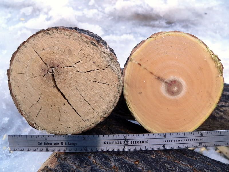

I found some chopped up pieces of tree in my neighbor's garbage area and decided to appropriate them for the test. I have no idea what kind of wood this is, so maybe someone can chip in with an ID based on appearance.
The victim:

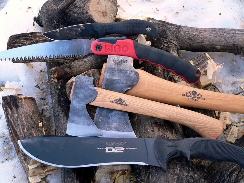

The contestants:
What we have here, left to right, are:
Gransfors Bruks Small Forest Axe 34.5oz
Gransfors Bruks Mini Belt Hatchet 15oz
Silky F-180 pruning saw 6.5oz
Kershaw Outcast 24oz
Scrapyard SS4 (INFI) 9.5oz

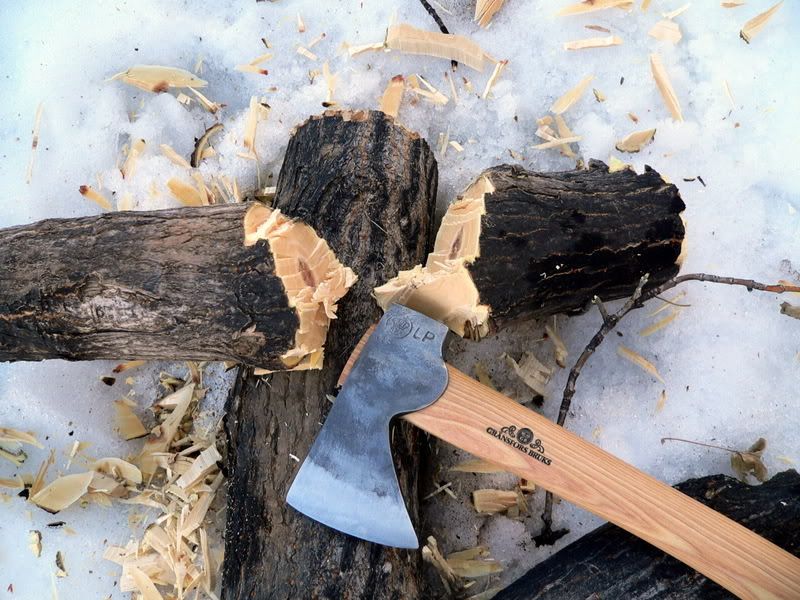

I started with the Small Forest Axe because I wanted the most wood on the ground in case my aim was off. It took a few hits to get the feel of it, but I was immediately impressed by the penetration I was getting with the axe. Once I got into the swing of it, the large chips seemed to be just flying off, and it was very controllable. The SFA is the heaviest of the bunch, but since the inertia of the axe felt like it was doing a lot of the work, I didn't find it tiring to use. I went through the wood in 1:22.

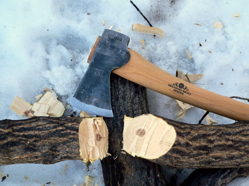

Next up was the Mini Belt Hatchet. As opposed to the SFA, it felt like I had to put more effort into chopping with the MBH. The chips were (predictably) much smaller, and I ended up turning the piece over about 3/4 of the way through in order to finish chopping through it. I don't feel that this is the fault of the hatchet as much as my fault for not starting with a wider cut. Elapsed time 2:38
As a side note with both of the GB axes: it's amazing the difference between these and the cheapo hatchets of my youth. If you've never used a really sharp axe before, you simply must try one. :)

Just for the info, the wood looks like some kind of oak.. relatively hard wood.. interesting test stuff, thanks for posting... Maxim

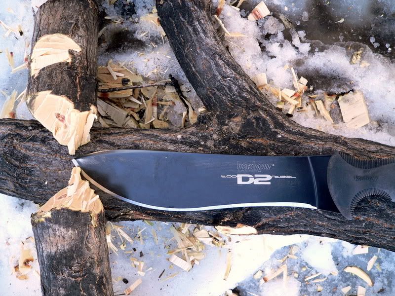

Next up was the Kershaw Outcast, which has been reprofiled to 30 degrees on a belt sander. In hand, this knife felt like more effort than the GB Mini, which I'm sure is a combination of the greater weight and less tip-heavy balance. The rubber handle felt secure, but rather narrow for chopping. It tended to stick in the wood more (V-grind versus convex?), and thus took a little more effort when I first started because I had to keep freeing it. Total time is 1:36

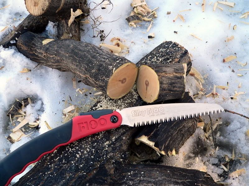

I next borrowed my wife's Silky F-180 folding pruning saw. Starting this was easy, and (unlike the previous tools), I never felt like it would send me to the emergency room if I slipped up. The uncoated blade did lightly bind a few times, but nothing serious. After cutting through the branch and stopping the timer, I was pretty surprised to see that the total elapsed time was 50 seconds!

Okay, to wrap it up, here's the results in one place:
Gransfors Bruks Small Forest Axe 34.5oz 1:22
Gransfors Bruks Mini Belt Hatchet 15oz 2:38
Silky F-180 pruning saw 6.5oz :50
Kershaw Outcast 24oz 1:36
Scrapyard SS4 (INFI) 9.5oz (batoned) 9:00

Secondly, and more importantly, don't underestimate the power of a good folding saw! Make that a GOOD folding saw. MPG may vary with brand or model selected.

i dont think that it is oak i do belive it is sassafrass
maybe a type of iron wood

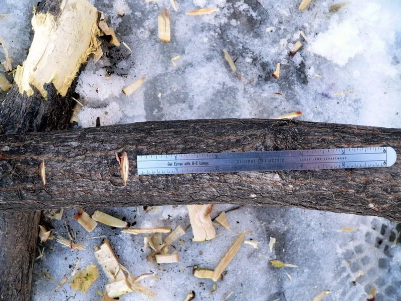

I like a small head on a long handle for a pack axe. I always forget about foldings saws(not manly enough) but I shouldn't because they are really good especially on small live branches axes are no good at. Archers swear by them for clearing their lanes.
