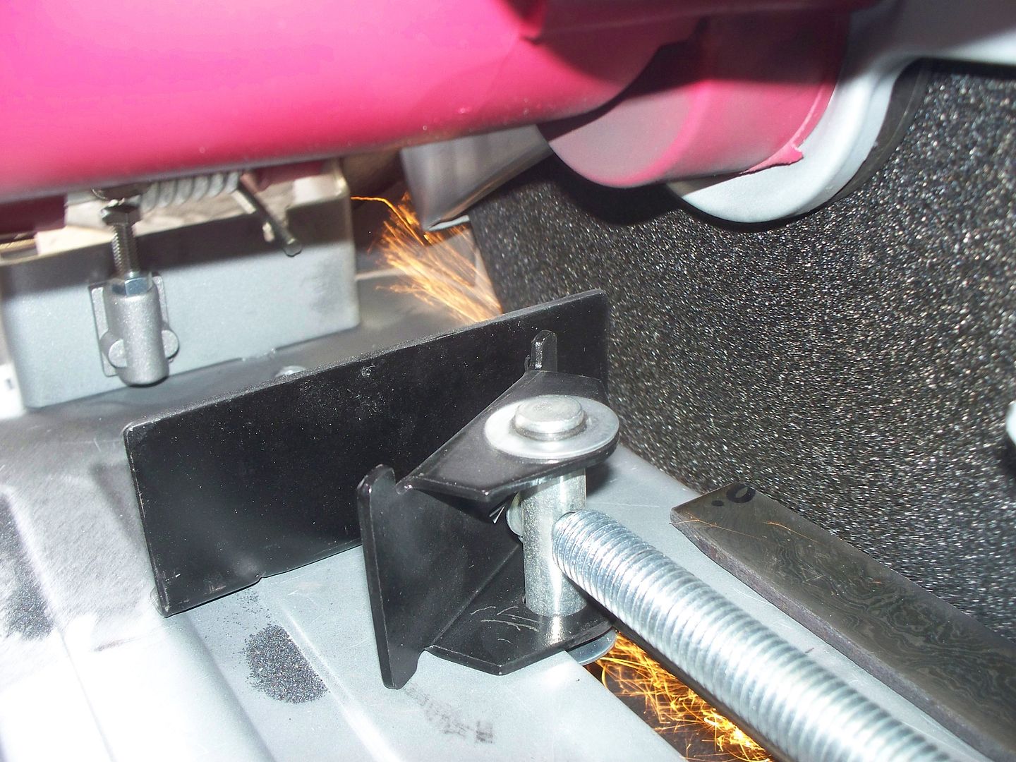

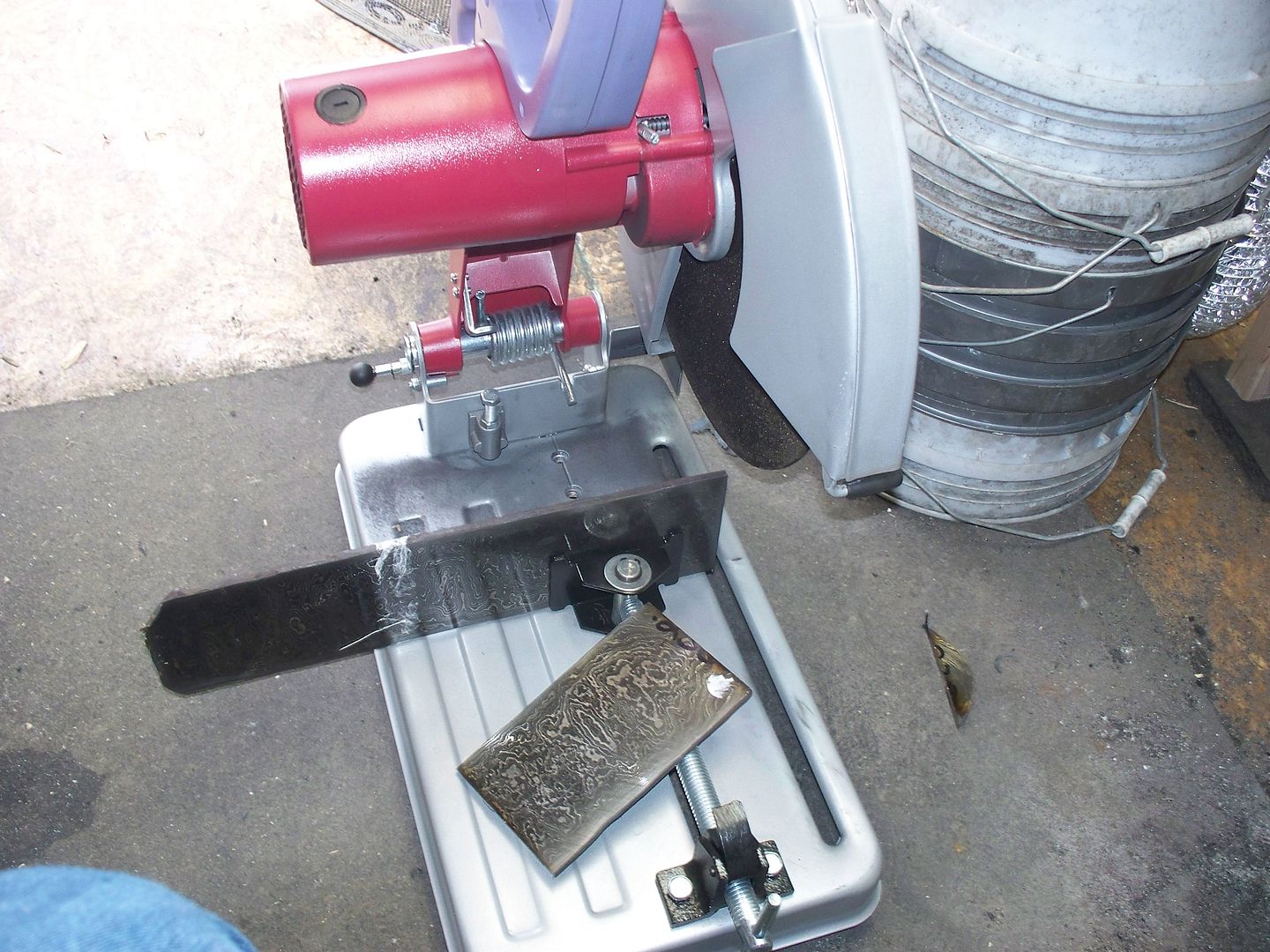

Here's the new chop saw, it will be a lot better than the carpenters saw with chop saw blade that I had been using. :D
Check the massive piece of .23" Damascus!

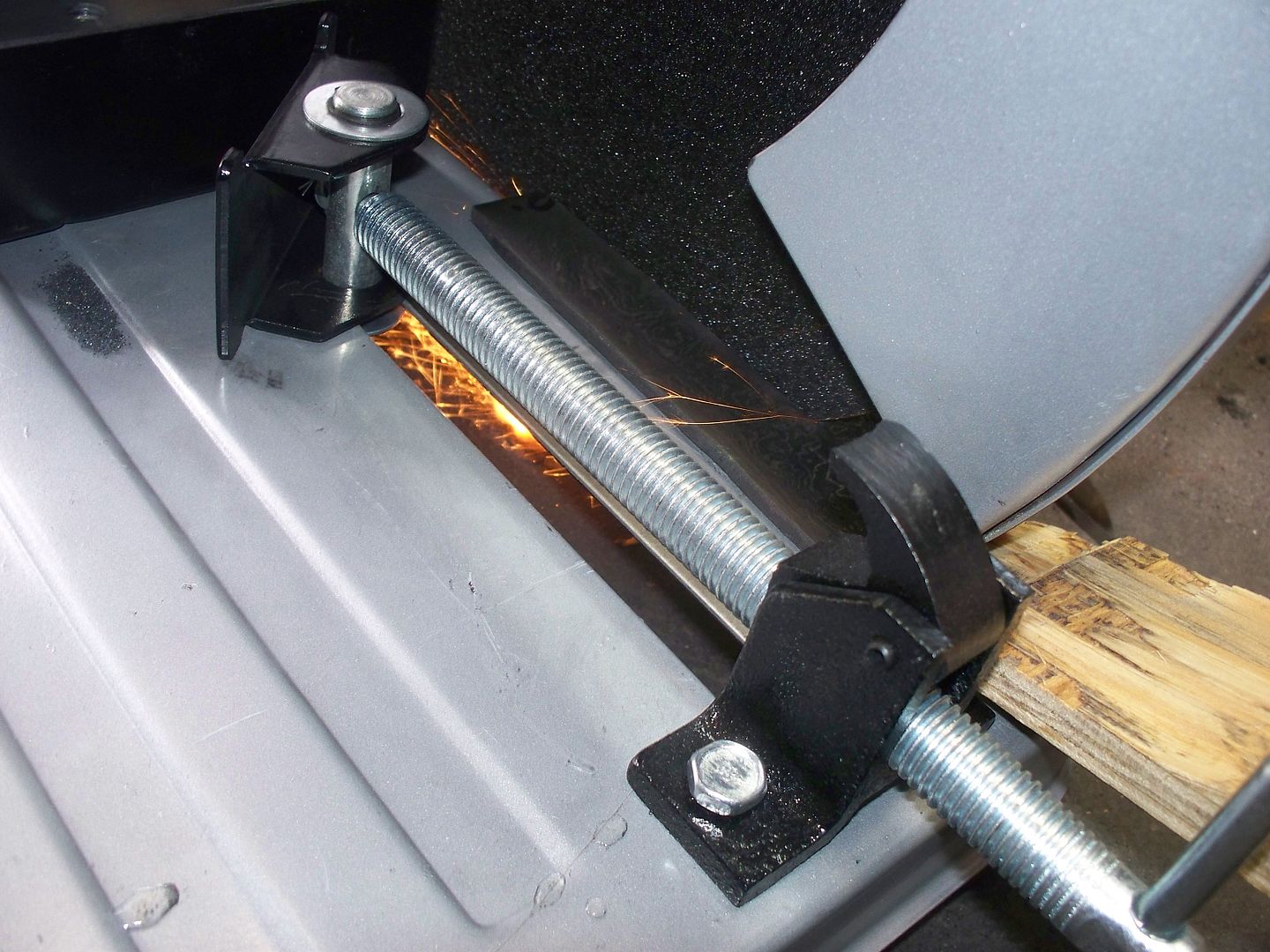

Using a push stick - I thought I could lay this stuff down flat and just chop it but it has to be slowly pushed into the saw instead
Damascus being cut!

The Damascus is 416 layer random pattern and made from 52100, 5160, 15n20 and 203e steels. I had been looking for a thick billet for a while and was excited to see this one, the pattern is really cool in my opinion and it is .23" thick!
damascus nerdery -
The 203e is for nickle content which really stands out when etched versus the other steels. The 15n20 has nickle in it too but etches a little more... then the 5160 and finally the 52100 which usually goes pure black.
