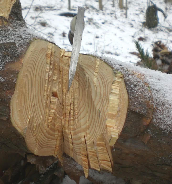

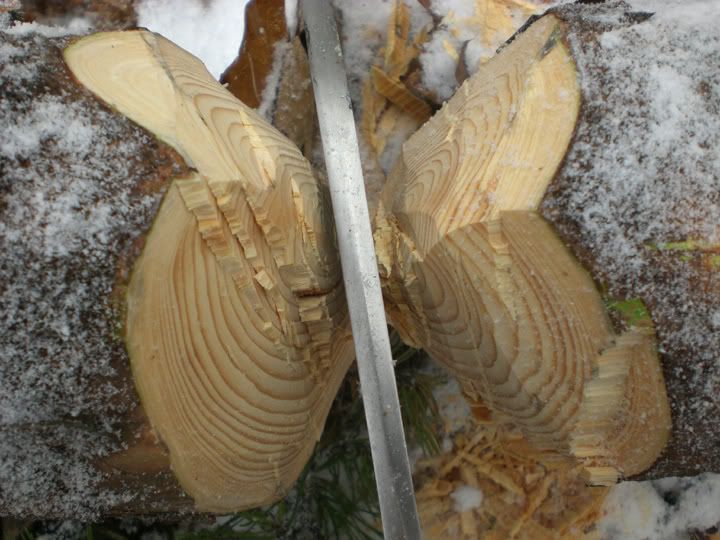

Small chops, let the blade do most of the work, don't try to "power through" the wood. During the swing you're imparting speed to the blade. At the point of impact your grip is stabilizing the handle end while the blade end chops into the wood.

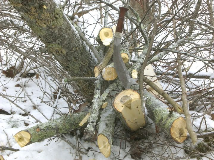

For me, I simply started hitting a dead tree until I could find advantages of the kukri.

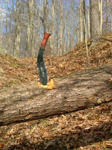

I saw one Youtube video of a guy with a khukuri hacking away at a log like it was his worst enemy. My wrist hurt just watching him.
You mean this guy David?
I hadn't sharpened the khukuri and it wasn't as sharp as it could be. Add to that the log was harder than I thought it was, which led me trying to muscle it a little. Normally I'm thru a log that size with much fewer chops with my 18" CAK :D :foot:

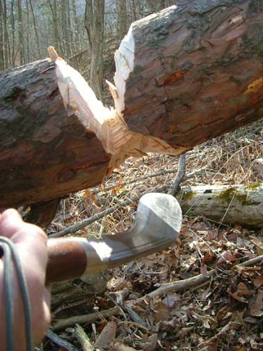

Ordinarily, you want to use the snap cut technique hitting the sweet spot and alternate strokes like you would use a hatchet to blow out the chunks.

As far as chopping style. I find that a controlled motion that uses a bit of drop at the legs/hips, a bit of turn at the waist, more effort at the shoulder, a bit of elbow and a moderate amount of wrist snap, all with a medium loose grip, that sort of adds to the snap but doesn't "Work" at it keeps any one muscle from being the weak spot that tires out quicker than the rest of me. My shoulders are by far the most involved in my swing. But as someone that used to swim competetively my shoulders are one of my strongest muscle groups so that works well for me. The basic technique is the same overall. but I think each of us modifies the swing a bit to rely on the unique mucles of each person.

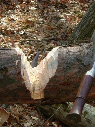

Then I like to sort of open up each side by changing sides and if I can come in from the bottom
