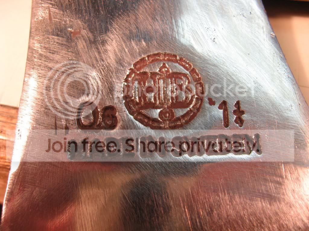

I use a 13-1/2" HB hatchet that I recently acquired at a gun & knife show. Before that, I was using a couple of small hatchets I inherited - nothing fancy, just small, sharp hatchets.
