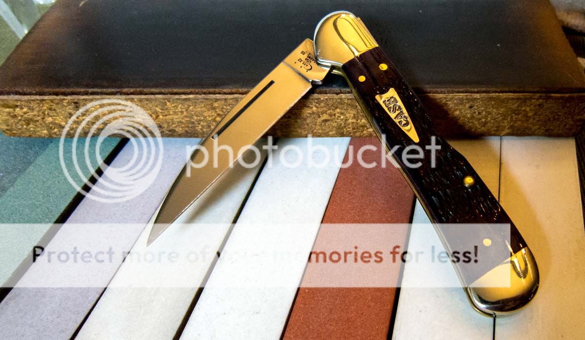

edited to add this shot, the 800 grit Chosera is the orangeish one just below the Case shield on the knife, plus it's a thicker version they sell too

A very nice stone indeed! Chosera, renamed the Naniwa Professional stones are very easy grinding stones making the sharpening experience very enjoyable. I prefer my Shapton Glass, but can't deny the greatness of the Naniwa stones.
