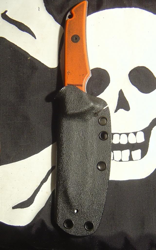

The knife is great, but I really want a higher riding kydex sheath. I have made a few sheaths and have gotten pretty good at it, but I'm having a lot of trouble with this one and need help. The thumb ramp is especially challenging, as is the choil, but what's really confusing me is the way that the blade is wider out towards the last third of the blade, before the clip point.
I made two sheaths so far, and both are less than perfect.
The two piece sheath went well during the molding and finishing processes, but when I tried to insert the knife it won't even go inside the sheath. I believe that this is because the blade is wider towards the tip, about 2/3 up.
The taco style 1 piece sheath turned out much better, but it lacks the retention that I need to be confident that I'm not going to lose my expensive knife.
I guess I'm looking for design advice more than anything else. I usually prefer two piece sheaths because the retention is easier to get right, but the widening of the blade is really throwing me off. I'll post a picture of what I have when I get home this afternoon.
