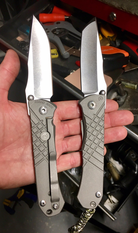

Recently I ordered a large Umnumzaan and tried over a week to open it easily, and many other ways too. Thumb- Numb- Zaan!

To me personally, it's like saying "Red wing boots cost $300+ so it shouldn't need to break in." But once it's broken in you'll know exactly why it's worth it.Umnumzaan thumb is a real thing!
i went through it twice, once with each Zaan. During break in, I would have to put the knife away for a few days periodically to let my thumb recover. In the end, it was worth the effort!
A few other things I did for break in:
-remove the pocket clip to make sure it wasn’t adding to the lockbar tension.
-run the pivot as loose as possible. No LockTite, adjust periodically.
-make sure there’s a sparing amount of fresh grease on the washers and detent ball track.
-I also did a quick pass of the washers over a strop, once or twice. Not a polish, just a smoothing of rough edges.
I understand those that’ll say a $400 knife shouldn’t need a lot of break in. I’ll also be quick to say that a well broken in Zaan is pretty amazing.
And then there’s the opening technique, which has already been mentioned. I found it intuitive—but it wasn’t joyful before my knives were broken in.

The thumb stud design on the Umnumzaan is very different than the sebenza. I like the Umnumzaan thumb studs much better, and I feel the rubber o-ring helps my thumb get a little extra traction when opening.It's a dumb design. CRK can't figure out how to make an ergonomic thumbstud. One of the few reasons to stay away.
