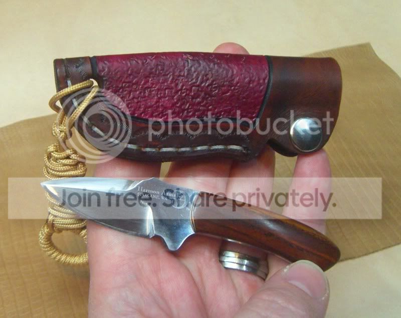

I don't pretend to be a great artist, but I'm pretty durn proud of this one!
4.25" OAL, 1.5" blade 1095 (HT by Delbert Ealy), tapered tang, bookmatched Cocobolo w/ hidden stainless pins, superglue finish. sheath is dyed oxblood and dk brown, stippled with elk leather inner collar. First knife i've used my maker stencil on.
It's going to my wife's oldest brother for Christmas. I'm going to have to do one for myself, because it kinda hurts to send it off! it's my Dogfish design (smallest out of my 7 knife Shark series) and has some Krein influence, as I'm sure you can see.
