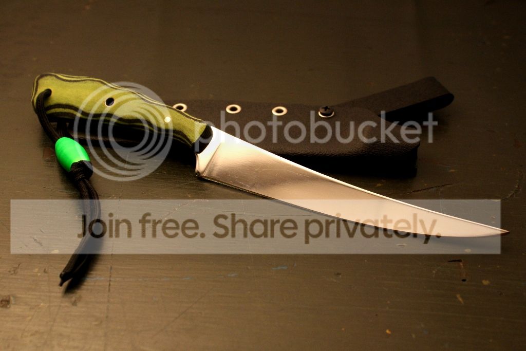

Here's a fillet knife I gave to my fiance's father for his birthday. It's a premade blade but I reshaped the tang and made the laminate handles and sheath.

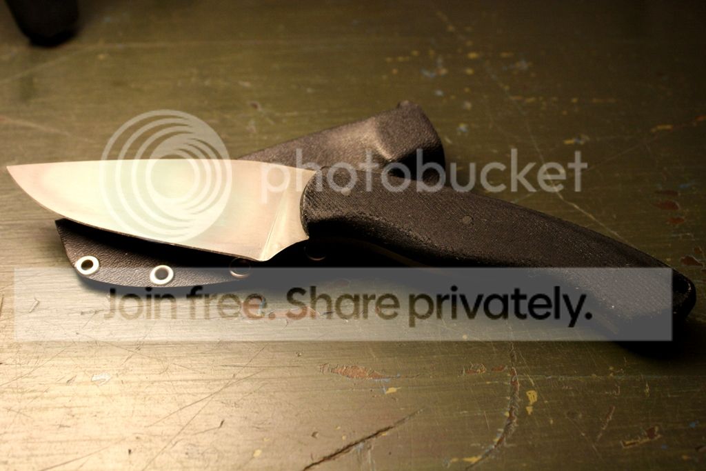

This one I made from Aldo's 1095 and heat treated myself. I'm thinking of giving it as a christmas gift, but I will probably try to make another one since there are a few flaws that are bugging me.
Tip: If you give a knife with a Kydex sheath to someone who's never had one before, show them how to remove the knife safely. When Ashley's dad pulled that fillet knife from its sheath he pulled the knife and sheath apart in both hands and when he felt the resistance kinda jerked them apart. He nearly stabbed himself in the arm. I quickly showed him the relief cuts and how to gently push the sheath away with his thumb. But I cringe even now just thinking how close he came to hurting himself the first time he held that knife.
