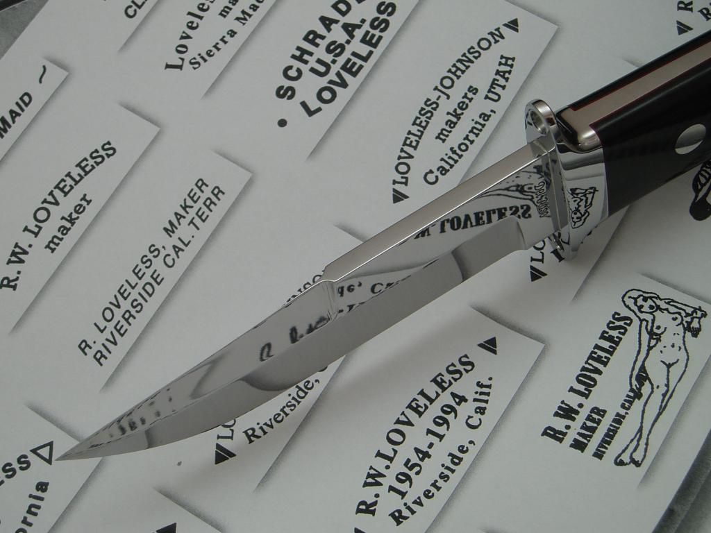

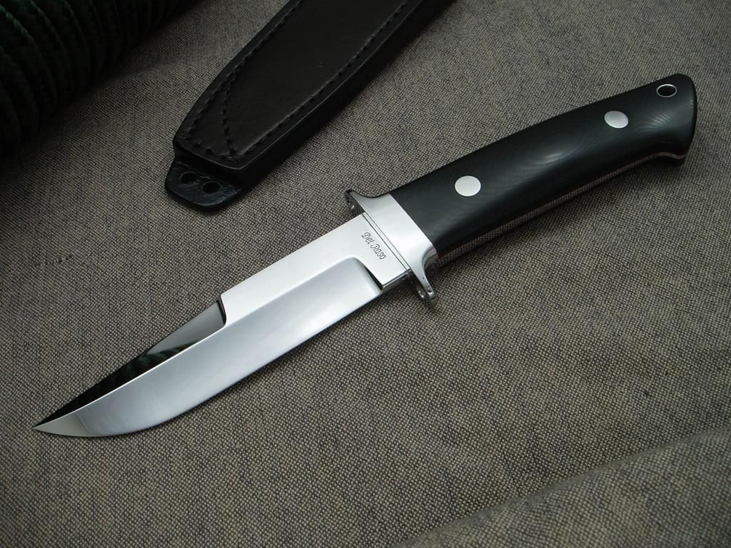

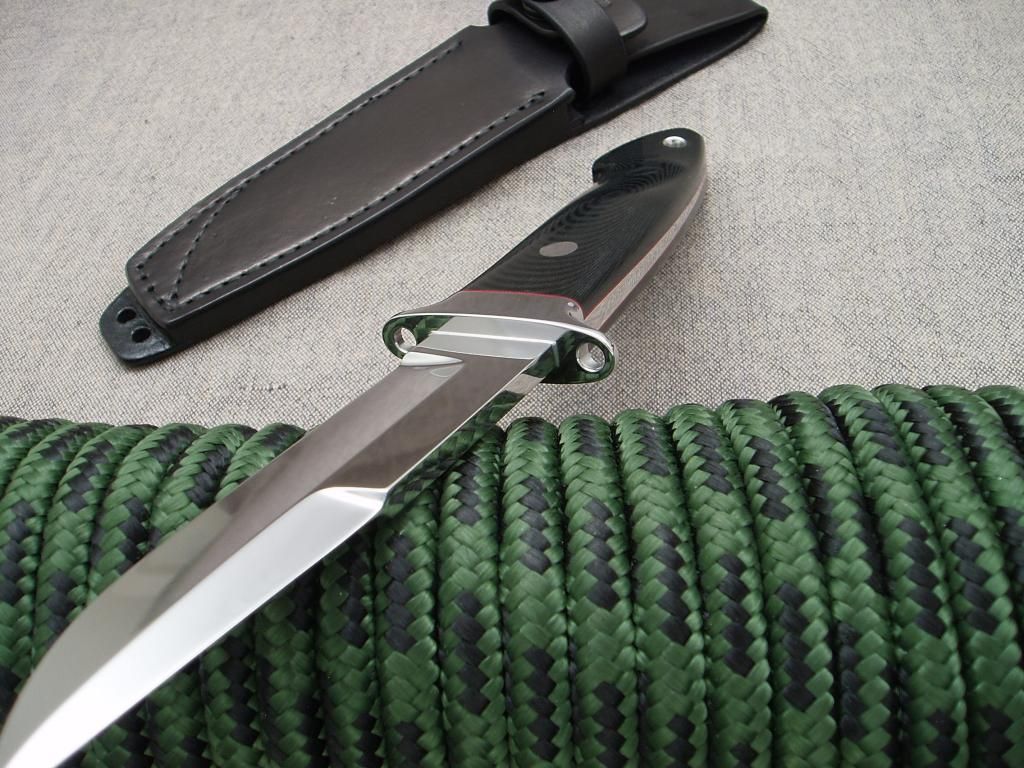

Just completed and ready to sharpen and ship. Loveless Chute knife in 3/16" ATS34, hollow ground, full tapered tang. and mirror polished. 416 guard pined and soldered.
Black linen micarta scales with red fibre liners and stainless Corbys and lanyard tube. Hope you like it.

This knife has two specific modifications that may not be immediately obvious from the photo. The first is a 5mm lengthening of the handle as requested by my customer after handling another I had at a show. Second is the placement of the lanyard tube. I have always had an issue with Bob having it so close to the edge of the tang. This is my issue and in no way diminishes my respect for the man's designs and legacy.

Really hard to tell much from those pictures which were taken at . . . some weird angles prone to distorting things, IMO.
While I am no expert like STeven, I will still offer my thoughts based only on what I see in the pictures . . . which might be off due to the pictures as noted above.
1) The handle looks nice. Looks to have really good palmswell.
2) The one thing I can tell for sure is that the junction of the blade and guard is extremely well executed. This is one area where so many Loveless style knives fall short, IMO.
3) I LIKE that the placement of the lanyard tube and agree that it is an improvement.
4) The blade grinds look a bit off. The upper sharpened edge looks too thin, and the bottom edge appears to be lacking the very subtle graceful undulation I expect to see on a Chute - it looks completely straight. Again, this may because we do not have anything approaching a straight-on view.
5) The guard appears to be a bit too thick at the tips and the tang a bit too wide at the guard.
Overall, it looks like a very nice knife that anyone should be proud to own.

Not to harp away on this, but I think a direct response is necessary since my comments were selectively quoted, and either misinterpreted or recontextualized.
I didn't say Loveless' patterns are boring, but that Loveless design knives, (aka; interpretations and copies) are, except for very few, for the reasons I thought were most relevant.
I consider this to be one of the few Loveless design knives that stand out, which is all the more remarkable, since Mr. Del Raso wasn't even working from an original template. It's a true interpretation, not a copy, and that's all the more impressive, since it is difficult to design a great looking knife using Loveless' build methods.
I was actually saying something that I have heard you say many times over the years, Steven. Perhaps I didn't say it clearly enough, I thought I had explained myself thoroughly. Sorry for the confusion.:o
