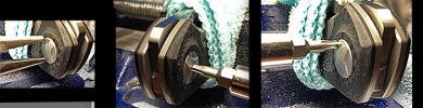

Anyone have any ideas on how to hold the non-torx side of the pivot motionless...so the torx side can be unscrewed for knife disassembly & pivot/bearings clean-out & re-lube? Both sides of the pivot appear VERY securely "lock-tited" together. When I turn the torx side of the pivot, the other side just turns in sync. Nothing on the opposite side of the pivot to grab on to...to keep it from turning, to break the locktite hold. Obviously no one wants to cosmetically screw up their knife's pivot in the process. Am I missing something obvious or is this an impossible task to accomplish? Can't be impossible! Can it? :cool:

Blues Bender - another great concept...tried it...quick pics attached to try to illustrate the problem....there's really nothing to grab onto on the reverse pivot screw...it is practically flat...as hard as I could press my locking needle nose pliers against the lower or depressed areas on back side pivot (covered with microfiber cloth to prevent scratching)...and turning that T10 torx on the opposite side, not enough depth to come close to being able to grab or stop the (back side) pivot from turning along with torx side. ARRRRRGH!!!!!! Also, much appreciated though.

Ok, first, I don't recommend that anyone do what I did. I was determined to find a solution, even at the cost of (possibly) damaging my knife (a little). Thankfully this worked out beautifully...no damage...vast improvement on knife's action.
Here's the abbreviated versions because I hate to type out novels.
1) I had my trusty bottle of Goof Off solvent ready to go.
2) I heated the pivot with a hair dryer at close range, set on high. It got the knife surprisingly hot within about 30 seconds.
3) picked up knife in a small hand towel as it was HOT...positioned it with backside/female side of pivot facing up
4) applied a TINY DOT of Krazy Glue to edge of backside pivot screw and affix it to carbon fiber scale with said dot of glue
5) waited 15 seconds for it to set (but pivot to remain hot)
6) flipped knife over, inserted torx driver & prayed
7) push torx bit in deep and turned it hard (but controlled)
8) pivot screws released from each other!!!
9) quickly began the process of using Goof Off on a paper towel to dissolve/remove dot of Krazy Glue as much as possible before complete disassembly and the COMPLETE removal of any remaining bit of any remnants of Krazy Glue on the Carbon Fiber & edge of back pivot screw (female side)
10) NO damage to carbon fiber or pivot screw
11) This Krazy© process allowed me to hold the backside screw in place securely enough to separate the two halves of the heavily (Loc-tied together...or whatever the Chinese or Russians use) pivot screw, male from female.
