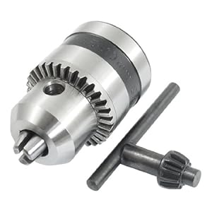

Another option for this type of pivot could be the using the chuck of a drill. I would think you could lay the drill on its side, hold the knife against the properly opened chuck (and hold the chuck to prevent it from turning) and then turn the torx on the other side. Just a thought.
Good idea, but the other side is just about completely flat.....nothing to grab.
