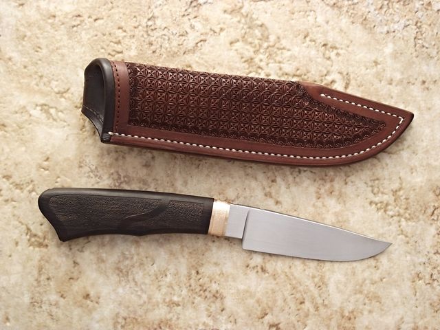

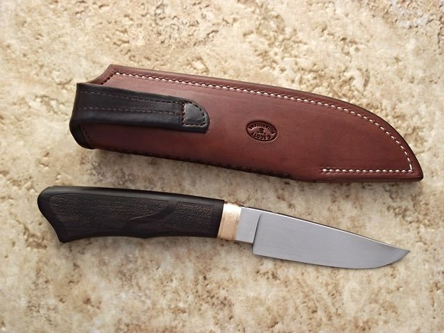

Here's one I just finished right in time for hunting season. :) This has a very slight and subtle upsweep to the point, I guess making it a trailing point of sorts. This one is slim in hand but quite stout in the blade. It would take a beating.
Claude Scott provided the fine leather sheath for this.
Specs:
Hand forged from 1095 steel, differentially hardened with time and temp control of my salts.

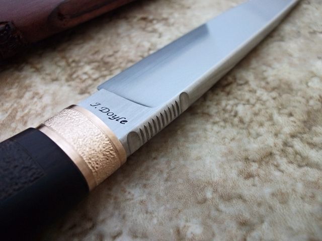

8 1/4" overall, 3 3/4" blade, .220" at the ricasso with a full radical distal taper ending in a very nice point

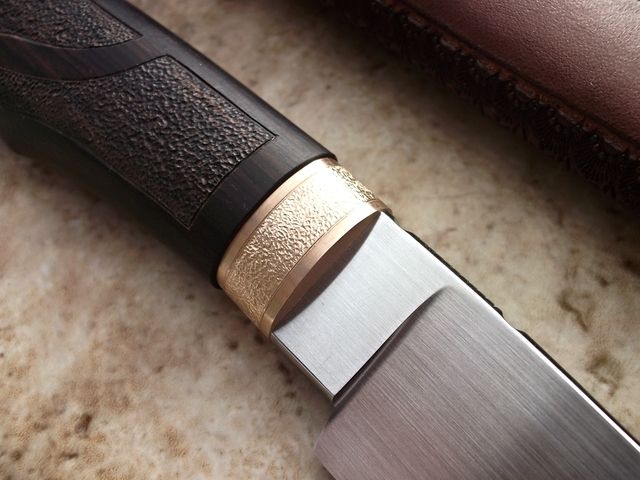

800 grit bright hand satin finish

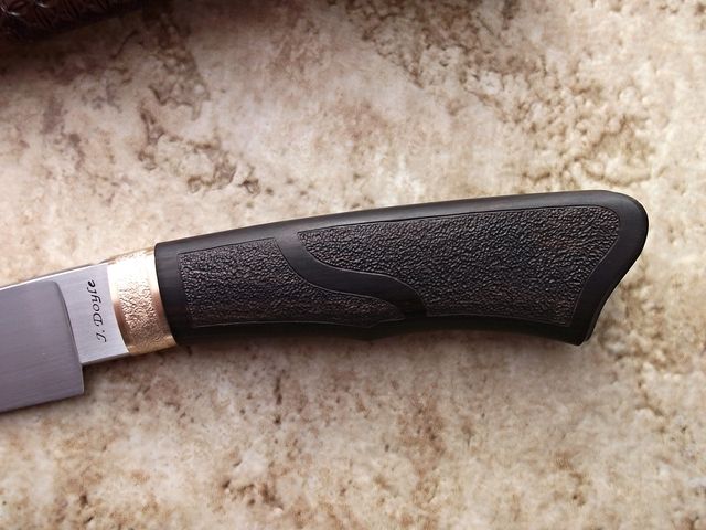

Bronze collar, carved and textured

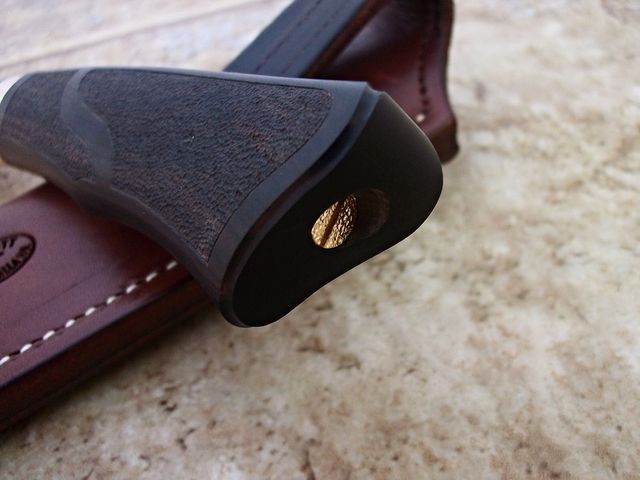

African Blackwood handle, contoured w/palm swell and carved/textured
Textured bronze finial
Heavily Rounded spine and ricasso edge for comfort
Rounded filed thumb grip
All comments and discussion welcome.

P.S. I recognize the woodworking of that handle!
Thanks Gentlemen!
Greg, good to see you my Friend. Yeah, you should recognize it some. :)
