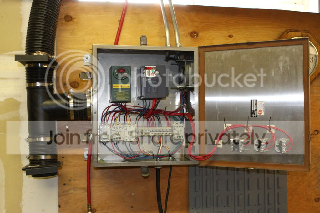

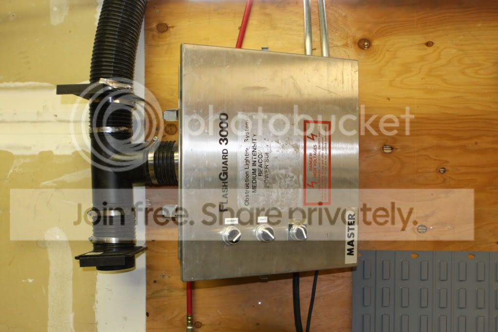

It depends on the NEMA rating, I put mine in a clean box. The black tubing on the left side of the box goes into my garage attic for clean air supply to the box. I wired a fan to come on when I power the VFD's
