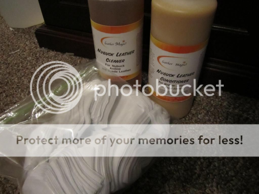

I have a ton of different strops , with a ton of different compounds on them. So cross contamination is a big concern.
I use these disposable cotton gun cleaning swaps and have been happy with the results from this leather magic cleaner/conditioner. They have two separate formulations , one for treated and one for untreated leathers. This is the stuff for untreated leathers. (as my roo strops are all untreated.)
I wouldn't use any solvents or alcohols myself. That kind of stuff would probably dry the leather out and make it more susceptible to wear.
Also when working with multiple strops and abrasives in these type of situations always start working with your finest strop/compound down to your coarsest. That way if there is any cross contamination its a moot point. And keep a clean working area.
