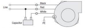

I picked up an older blower Monday. It moves a lot of air but gets pretty hot and starts to stink real fast. I blew it out with air and oiled the only spot I could find but it only helped a little. It has 3 wires, red, white, and black. I can get it to run with the red and black wire but not sure what to do with the white wire. Any suggestions?

Its not 220, says 115 on the motor. I tried running the white wire both with the red and then with the black and it slowed it down considerably. It runs fine off the black and red wire but its the heat, smell, and smoke that concerns me. It also wouldn't surprise me if a cat didn't baptize it over the years.

its a capacitor run motor, you need to hook a cap to the motor between the red and white wire. the motor is fighting very hard to run without the cap and I'm sup prized that it starts by its self with out the cap. here is a picture drawing of what i mean

I'm not to sure if I even have the blower now. Pretty sure I tossed it. Thanks for the information but I think its to late.
