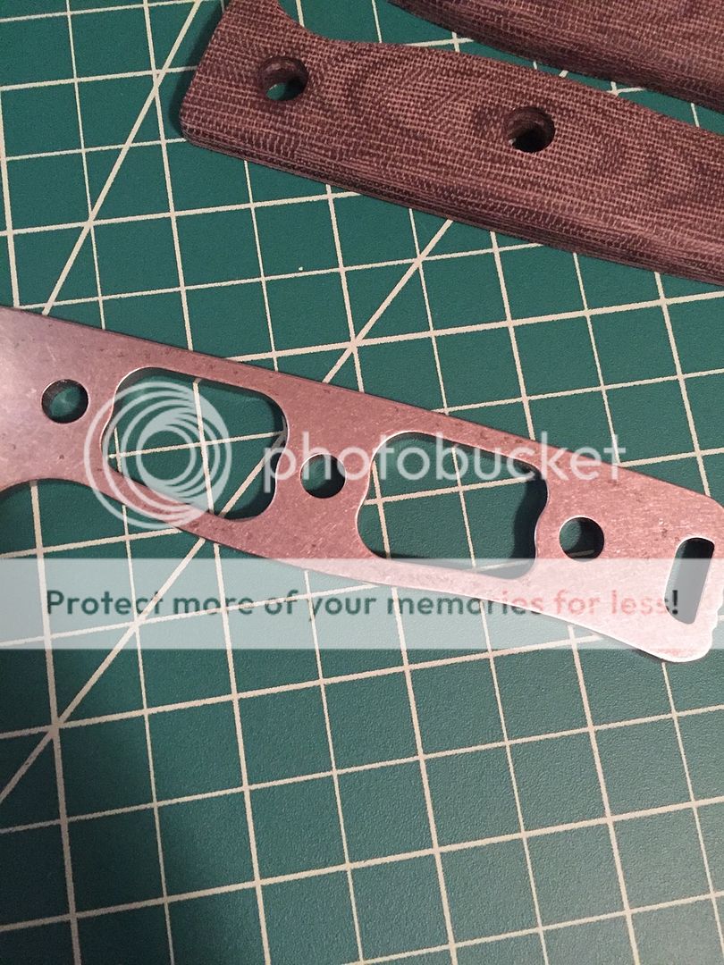

I decided after my recent trip to give my 4.1 a spa treatment, and found a little freckling under the handle (my bad for not putting anything on them). I'm not worried about it at all, if there is an easy way to get rid of it i will, otherwise im just gonna lube it up and put the freshly cleaned scales back on!
As for the mineral oil, it made the handles look exactly like they did when dirty, not "vibrant" like I expected. I did a quick water only rinse and dry and the color came out between crazy dark and super light, so I am happy with that.

I haven't used it myself, but everyone says to use steel wool for a case of the freckles.

Try soaking them in soapy water then scrub the crap out of them. I use Vaseline on my scales and wipe them off until they're not greasy. The colors seem to pop and it doesn't evaporate like mineral oil.
My friend Josh used one of those blade erasers and said it took the spots right off of the 3v.

Standard, I got a blade eraser to try after your suggestion, boom! Works great. Gotta be careful with the stonewash a bit.
Also, I frog lubed the hell out of the underside of the knife handles, so it should be all good this time, and subsequently sorta darkened the scales...I got the stuff everywhere....
