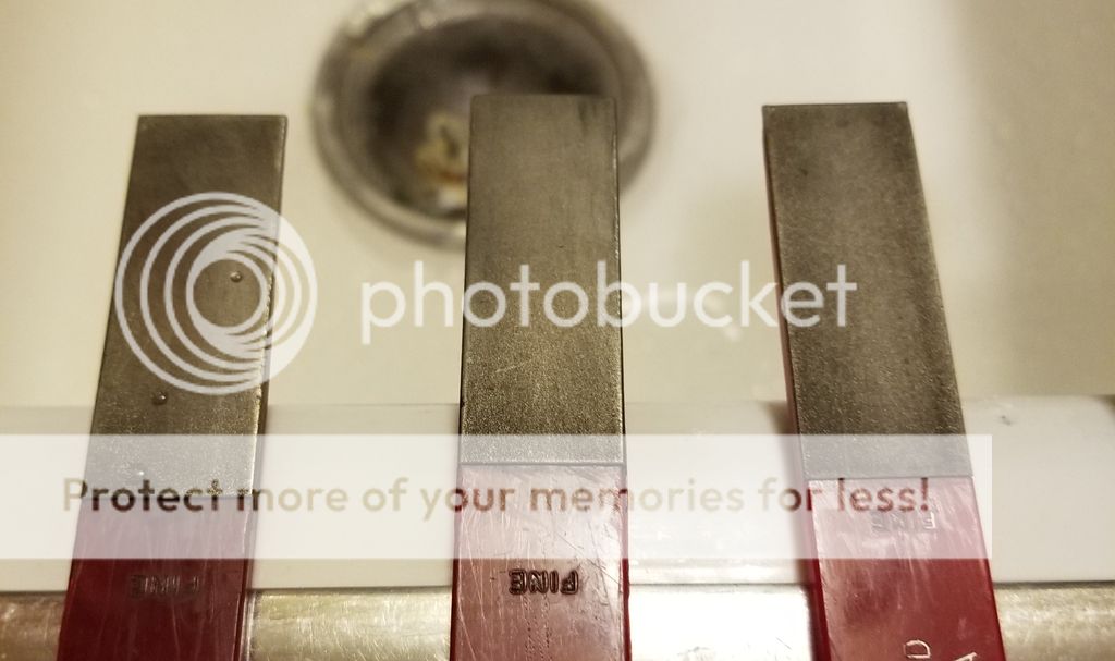

Cleaning diamond stones
He's a good shot of the effectiveness of BKF. These are 3 EZE-Lap diamond slip stones I use in machine shop work. They are in varying levels of wear. The left most one is quite worn out, the middle is fairly worn and the right side one is fairly new. You can see the difference in swarf build-up pretty clearly in the before photo. The left two are worn enough to be quite fine, so they don't collect as much steel. The right one is quite aggressive still since it's still new and it collects quite a lot of swarf as you can see by the embedded black steel.
Apply BKF paste. Wait for 5 minutes.
Scrub with a plastic dish scrubber sponge and rinse thoroughly. Et voila, hones are free of embedded steel.

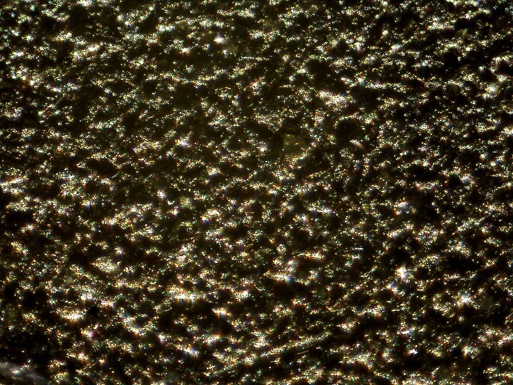

Nice one. I'll raise you one. The "new" eze-lap. Check out the range of diamond size. You can understand this if you think about it. When they use mesh to separate, long diamond pieces that are the right diameter can still get through. To help done guys who aren't familiar, remember: thousandths of a millimeter are microns, so these sizes are basically read as microns if you remove the decimal point.
Here "slight wear" - notice the diamonds are mostly rubbed flat with the nickel, but still there:
And here, a ring light shot of "holy Ishtar."
