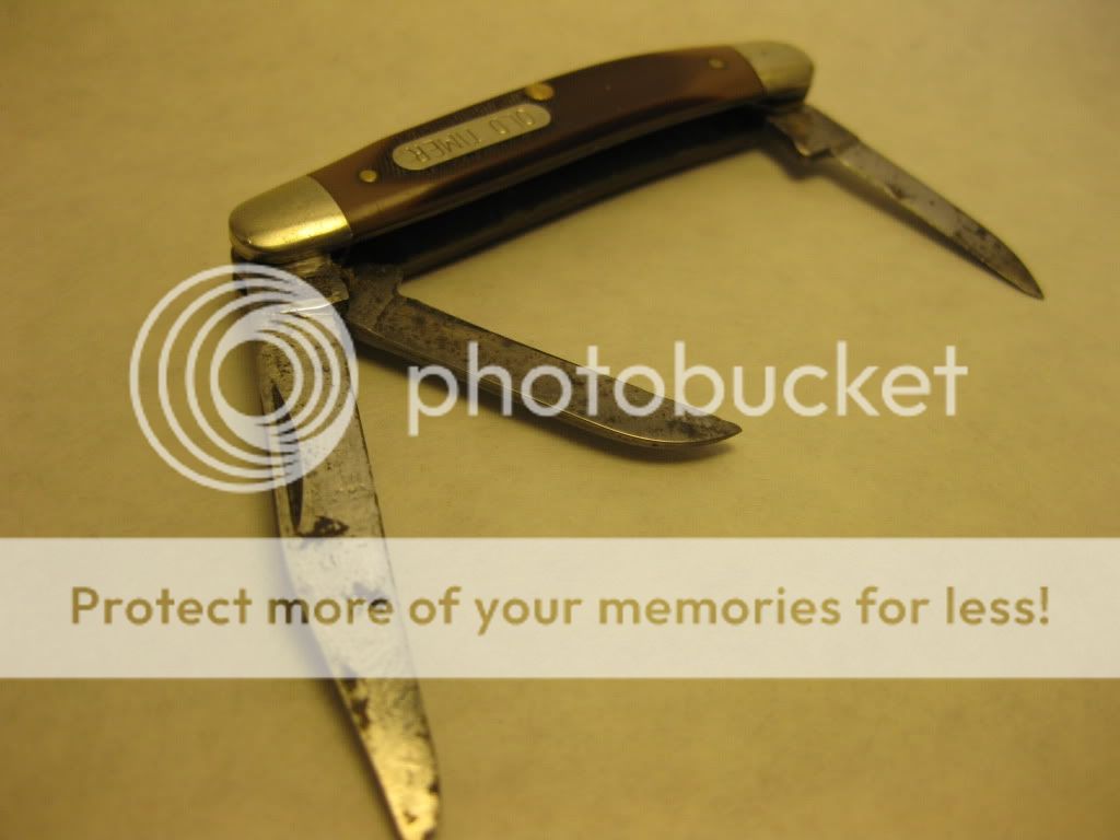

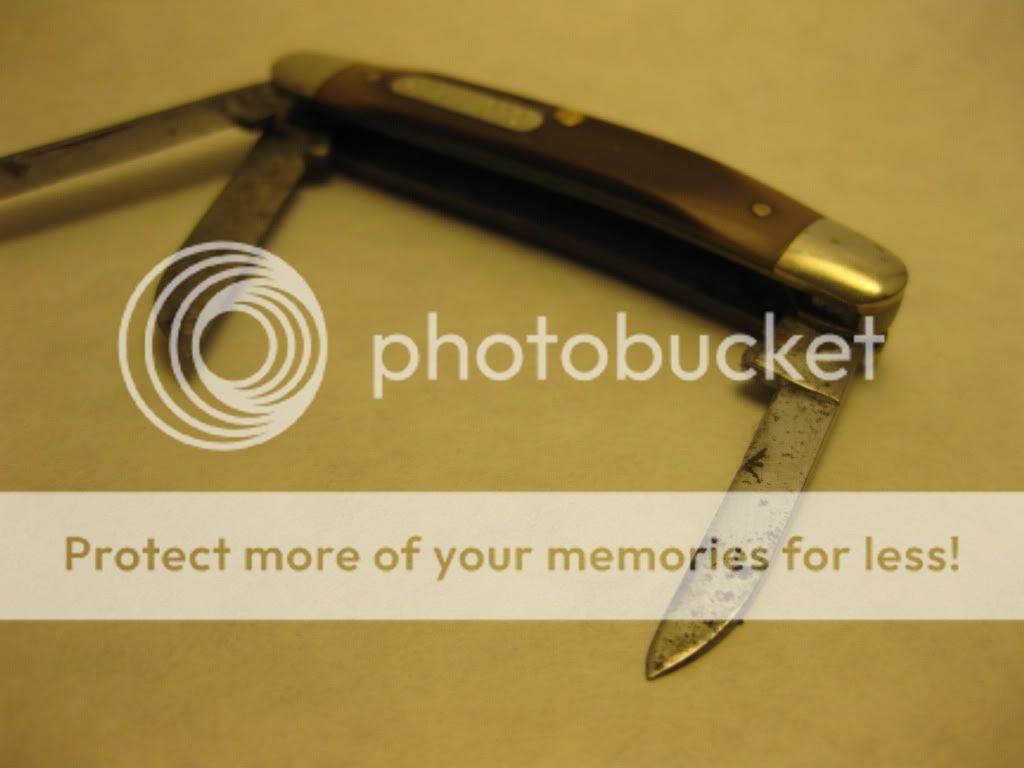

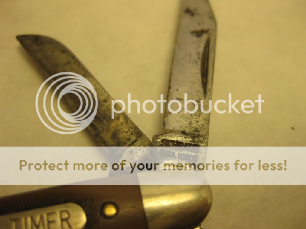

I was just given this knife from a friend of mine. It is a US made Old Timer. It is pretty beat up and gritty. I was wondering how one would go about cleaning it up. There is plenty of rust on the inside of the knife and the action is far from smooth. Could a mineral spirits bath do the trick? Thanks
If it was mine, i would pour it full of dishwashing liquid and start working the blades open and shut. Rinse with scalding hot water and then repeat as manytimes as it takes to get rid of dirt and grime. I would then wrap the blades in paper towel and then moisten the towels with vinegar. Let the knife set 12-24 hours. When you unwrap, you will be totally horrified. The blades will be blackened as if burned. The black can easily be cleaned off with dish soap and a clothe. This will leave some patina. If you want shiny blades, rub em with nylon mesh scouring pads, what i call "scotch-brite" pads I would then leave the knife submerged in mineral oil for some time. Work the blades open and shut and wipe off excess oil. DON"T DO ANY OF THIS IF YOU THINK IT HAS COLLECTOR VALUE ! this is only to restore a user knife. HENRY

I am by no means a collector, just a humble user. I soaked the entire knife in rubbing alcohol for about 30 minutes. It got the action much, much smoother, but still, there is rust on the inside of the knife, on the back springs. I will soak it in mineral oil or WD-40, whichever I can find easier. How long should I submerge the knife?
The most painless way to get rid of rust is vinegar. Give it a good soak for 30 minutes and see where that gets you.
Go down to your local auto parts store and ask for "Evap-O-Rust". You should be able to buy it in a pint plastic bottle. The stuff is amazing. I have used it to clean and recover a lot of small, ferrous car parts. You can look it up on line and check it out if you want to do some research before you buy it. Make sure the knife has absolutely no oil in or on it. Evaap-o-rust won'tr remove oil, grease or work on surfaces with them on it. Crack the blades open to 90 degrees and let it soak in the solution for as long as you like. Really heavy rust might take a couple of days, but it will not harm any other surface. It just eats the rust. Then you can rinse it off with water, dry it off and see what else you need to do. If you need to do some more clean up you can move on to some of the other stuff like 000 steel wool and simi-chrome polish on the blades and metal surfaces. I didn't check out the thread above, but I'm sure there is good stuff in there too.

Well I took some sandpaper to the blades and get a lot of the grime and whatnot off. I also used a tooth brush and scrubbed the inside of the knife a little and got a lot of the rust out. There is still a tiny bit. I'll try WD40 some time this weekend. Thanks, everyone!
