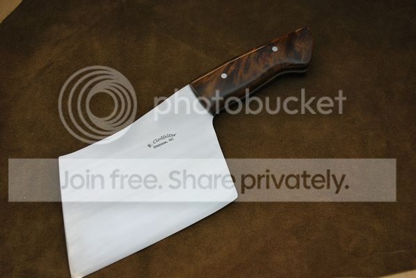

I made this one from 1/8" 1095 and took it down to about 20 thou before convexing the edge. It is sharp but not sharpened like a knife.
