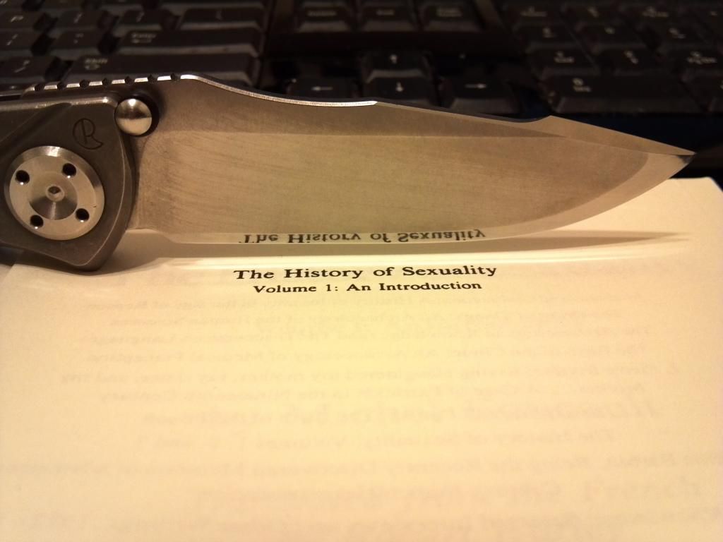

Here they are these are pretty low angles from cynic. He posted about a year ago on mirror edges. These are beautiful. Not sure the angles though.
Hi Sharpnessis, thanks for keeping me in mind.
These were done with a 10 degrees per side (20 inclusive) bevel with a ~15 degree per side microbevel (30 inclusive) which were measured by angle cube (for the bevel setting) and then rough estimation for the microbevel.
After some thought, I'm quite certain that the bevels are actually lower than 10 degrees per side. Since I zero the Edge Pro angle measurement with the angle cube without a knife on the ramp and I don't raise the angle from the face of a flat grind when sharpening - in other words half of the angle of the primary grind - I should really subtract that difference in angle from the bevel measurement.
Provided that my thinking is correct, I likely have bevels on the order of ~7.5 degrees per side or 15 inclusive.
