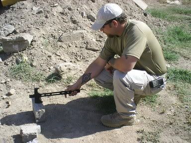

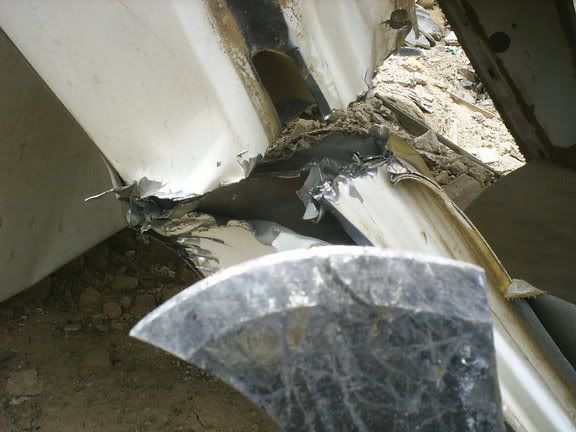

Unless you are packing a machete, saw or axe, or expect no significant wood work, then I would look into a slighly larger blade. The RD6 from Ranger Knives would give enough blade length to easily cut down saplings and as well be able to baton through thicker wood, if you do order one, specify the flat ground one with a profile for general wood craft not tactical because tactical to Justin means use like this :
http://img.photobucket.com/albums/v618/RangerJD/77rk.jpg
and :
http://img.photobucket.com/albums/v618/RangerJD/concrete.jpg
