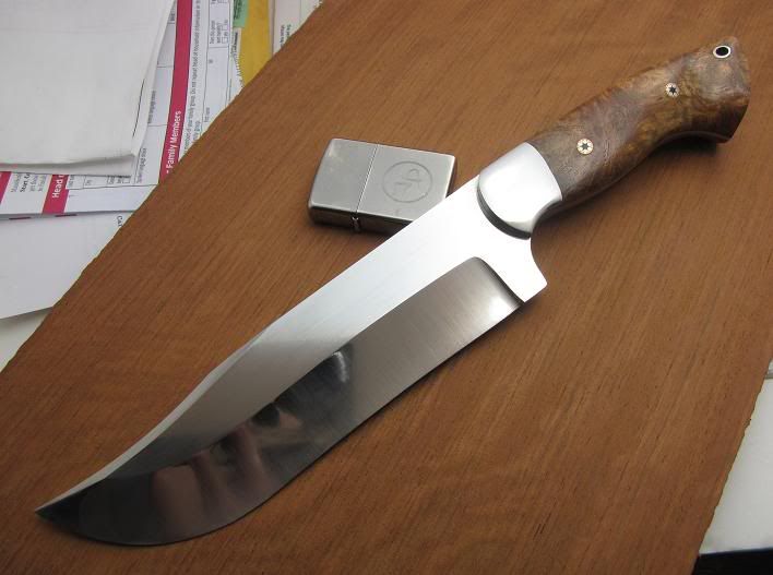

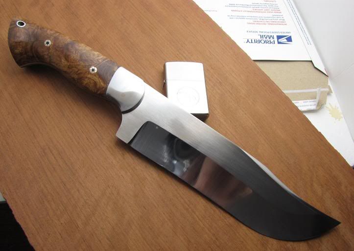

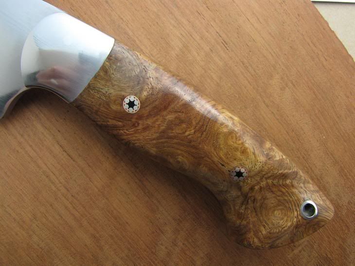

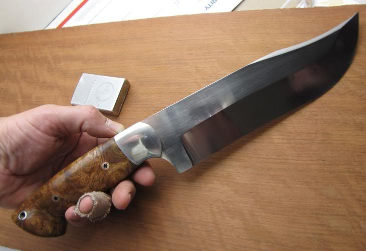

So I thought I needed to do something with alittle more challenge, for me..
I am looking forward to making some stuff out of the slab of curl brazilian rosewood I used for a backdrop.

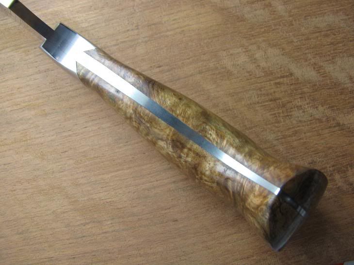

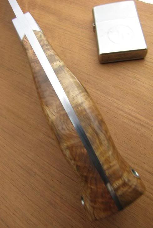

Oh the knife is 3/16" O-1, tapered tang(ends at the dovetail), 304 SS dovetailed bolsters(with 416SS Pins, my mistake I thought all I had was 416SS), amboyna burl( which looks reder in person but my picctures need improvement), with copper mosaic pins.
thanks for looking
Paul
WOW That is a VERY nice looking knife. The blade grind looks great as do the dovetail bolsters, tapered tang and handle contour. Seeing the pictures makes me want to hold it:D
It looks really well made Paul.
Peter
WOW is that clean, Paulie... great combination of materials, too.
The clip is frickin' scary looking!

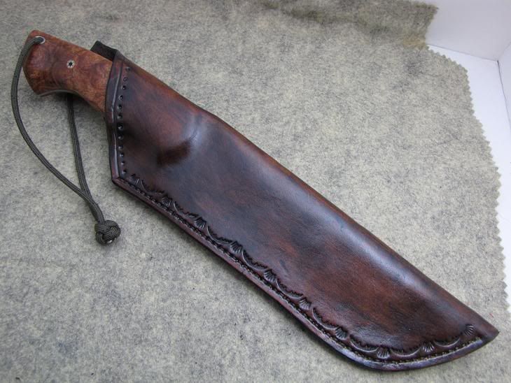

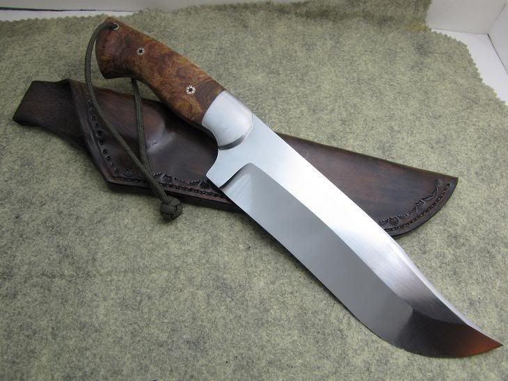

here's a couple more with the sheath I just finished up. Now off to Dave V. for some work.
