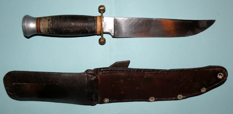

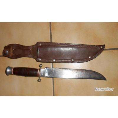

In Europe, from the 1930s to the 1970s, the name "Boy Scout knife" applied to a specific knife design that had a 7" blade and was built like a true fighting knife: It is the only specific knife design that I know of that is referred to generically as a "Boy Scout Knife" by Europeans of a certain age: This style of knife was often carried in combat by French soldiers in Algeria, among whom my father: They were very finely made, despite production in the millions intended for ten year olds, and the carbon versions were extremely sharp (the stainless ones were hard to get sharp, for some reason):
Blade length was typically 7" on a 4" handle, for 11" overall: Over 3/16" stock at the guard, very strong, with a full distal taper, extremely light as a result (much too light in my opinion):
These knives were then carried with great satisfaction by French soldiers in Algeria, where you never knew when and where the enemy might turn up. You could be his guest and he would treat you well, until the moment you left his home... Quite comparable to Irak, except Algeria was a lot bloodier... You never knew who you were dealing with...
These knives were considered modest enough to be routinely issued to millions of ten year old Boy Scouts... It would be quite amazing historically if the US Army had grown so PC that these Boy Scout knives, intended for ten year old civilians in the millions, would now be forbidden to modern front line soldiers...
