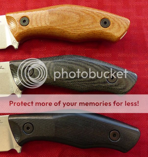

These are some pictures of what it doesn't look like:
^ that is the previous version, it will have a few tweaks.
This is a computer rendering of the EDC2
This is an overlay illustrating the tweaks from the original
As you can see it's a hair longer, the belly is pushed out towards the tip and the grind comes up a little higher due to tweaking from .135" to .145". The bevel angles and edge geometry are unchanged. Not seen, the scales are being trimmed down a tad to be a little bit thinner. Not much.
