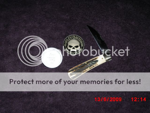

There was a time, at the beginning, that GEC did not put the shield on some stag covers. They shipped the shield as a separate item in the tube.

That is/was only on Genuine Stag Handles, not Burnt Stag. They always put Shields on Burnt Stag. The OP's knife is Elk anyway.

I was careful to say some stag. Yes, the OP's knife is covered with Elk but stag is also being referenced in this thread. WD40 hasn't been mentioned in the thread yet but who knows what could happen.
