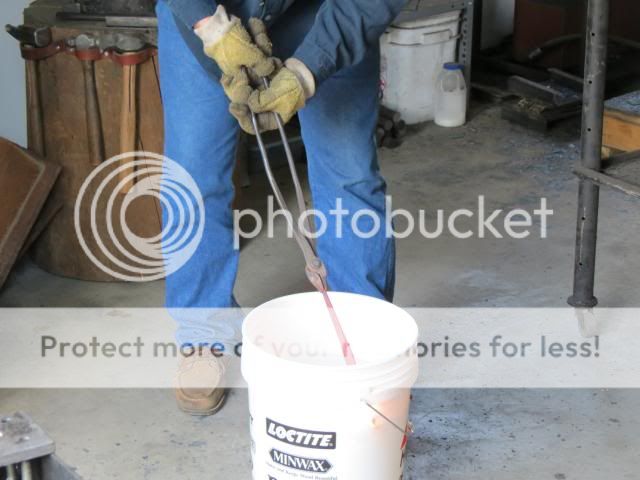

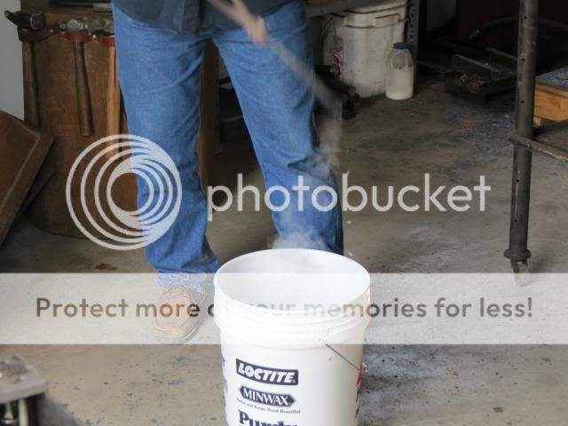

I watched Bruce Bingenheimer do a demo at a hammer in last year on this. He used 1095, a forge, and a 5 gallon bucket of hot water. After holding the blade at the correct temp for a prescribed time, he VERY quickly dunked it in the water and agitated it for a fast 5 seconds, then back out. You could see very similar "marks" on the blade like yours showed in the video afterwards.
I was fortunate enough to see one of the two blades he did finished out. It was incredible-the wispy, cloudy look was just plain impressive. I couldn't keep from staring and turning the blade over and over.
Just goes to show-do enough work and testing, and it most certainly can be done, and done quite well.

Yup, it was a great demo and I'm pretty certain there was some "pucker" being shared by those watching ;). I looked and had a few pics that I figured I'd share-I don't think Bing would mind.
Him answering questions while bringing a blade up to temp:
You wouldn't guess he could move so fast and he didn't end up melting the bucket, either :) :
Still smoking hot
