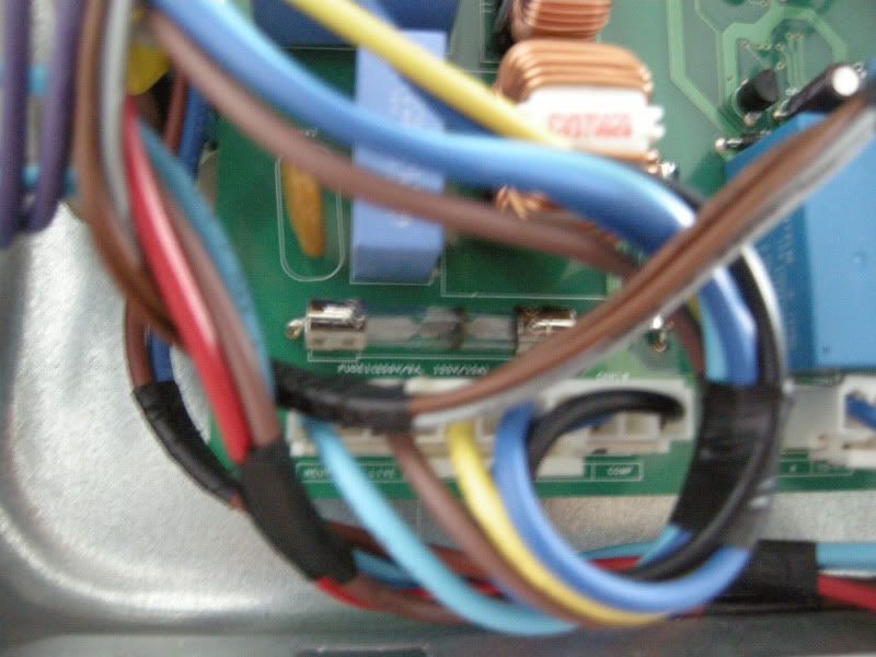

To me it seems like to fuse is burned out on the pic anove (the black line in the middle)

I dont see a fuse in that picture.
can you put a mark by it with paintshop?
that round thing towards the top,looks burnt to me,
is a capacitor. the thing just to the left also looks burnt.
if you can read the numer on the circuit board it will help identify
what it is. like C109 is Capacitor D34 is Diode F205 is Fuse 205

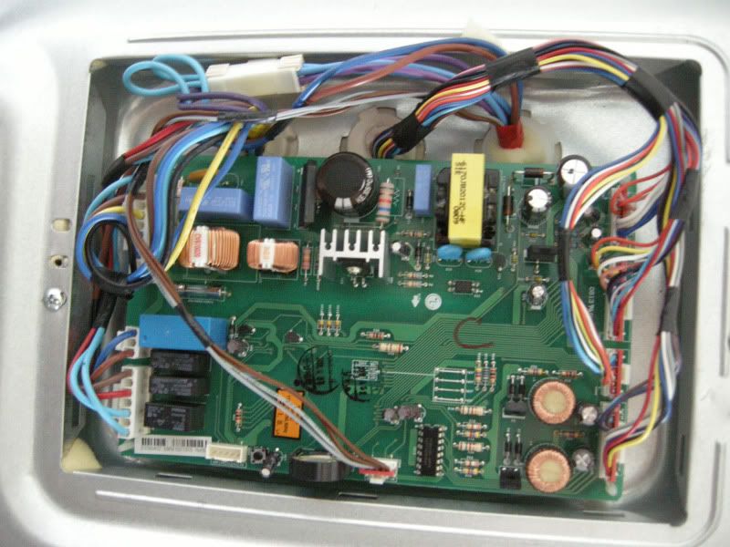

second picture just showed up
ya,blown fuse
cant really see if that is a fuse you can replace without soldering
the capacitor at the top does look burnt to me though.

I'm gonna try soldering the new fuse tomorrow, well my buds is however I have small faith that we'll repair it.
I'm thinking more and more along the lines of a new board and a repairmen.
if you can taker a better picture
it "looks" like that fuse has 2 "cups" on the ends
you sometimes can slide them outwards and slip
in a new fuse.
otherwise he just needs to unsolder 1 side
Fuse is def cooked. There probably is a reason. Don't let your friend talk you into putting in a higher rated one. You'll burn down your house.
