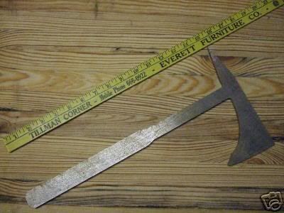

I'm wanting to do a few tomahawks being 16 to 18 inches long and from the axe blade to the spike on the back of the blade 6 to 8 inches wide and the axe blade being 3 inches. I'd like it to be .750 of a inch thick and I'm not sure what steel to use I'm looking at O-1 and A-2 right now. I'm wanting it to look a little like this one but with a more curved spike.
Wow, that's not going to be a cheap part to make!
The material is not going to be cheap at 3/4 inch O-1 or A-2 plate, and there will be a good deal of waste no matter how you nest that shape.
You're probably looking at waterjetting as your only viable option at 3/4 inch.
I'd be surprised if you could blank that for less than $100 per unit after materials, frankly I'd suspect it'd be more than that... remember, you're paying for the material you don't use too and cutting 3/4 inch plate steel is going to take up some machine time.

I suspect they're cast, then ground. (BTW, no matter what you do, however, you should probably do a radius where the head turns into the handle, as seen on the Estwing products. There will be a lot of stress right there and those sharp corners are inviting a crack.)
Which steel and HT would be the question, but if you're after an integral hawk like that without costing a fortune, you may want to look into it. --shell casting, I would think would be the closest affordable casting approach for small numbers. ---. It'll still cost money up front for wax molds, etc, but if you're going to do 10 or 12, I would think you'd still be ahead compared with cutting it out of A2 plate and grinding the shape, etc.
The only other think I can think of is if you luck out and score some appropriate steel plate really cheap as salvage or something. It'll still probably cost $40, $50 or more to waterjet that shape ....

Just got an email back from them they want $29 per axe just to cut it for SS and $11 for Alu. Just have to find a place that sells the metal I want I was thinking of 1095 .500 thick. Tell me what you guys think I'm also going to be willing to send the axes out to be heat treated if there is a better metal out there that might cut cost down.
I would expect a quote for .500 is going to be cheaper than .750. Still, $29 is cheap for a shape like that in .500 steel.:thumbup: I'll have to quote them on some work I have coming up.
Still, I think you might be dissatisfied with .500. I assumed that you wanted it thick so you could carve the thing out ... Trim down the neck .... leave some meat on the head, etc.
.500 is not going to give you much room to do that. It might be fine, but you should make sure.
I would urge you to make this thing out of a 1/2 inch plank of wood first. Carve it out the way you plan and see if the proportions are what you want. A little more effort at this stage can save you a lot of heartache later! Good Luck!
