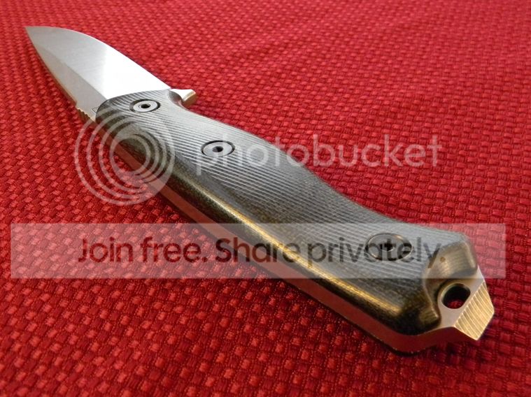

Something that's important when considering having scales made, is the quality of the work can only be as good as the underlying geometry.
4.jpg~original
There's a Dunning Kruger Effect when a CNC shop is making scales for people. Generally speaking, the organic surface modeling is not a core competency of most job shops. This is also true for the Knifemaker doing his own 3D CAD work and is the primary reason why midtec scales frequently have a crappy clunky look and feel to them.
There is a lot more to good CNC scales than a good CNC machine. Quality programming, and most important, high end surface modeling.
... just something to consider, look at relevant examples of their previous work...
Also, something Nathan mentioned to me when he and I discussed something similar last year; be careful about having one shop do the cad for the blades and another for the scales. Try to have one shop do both. It will make everything easier to fit correctly.

Nathan, is that picture representative of the finish of your scales as delivered?
Yes, it can be. Those are as machined and buffed to bring out the color. We can do that, but most folks take them as machined and do any secondary finishing themselves.
Some folks tumble the scale or grit blast them. Some leave them as machined. I like a quick buff. Coarser textures often get a rub with some fine grit paper or belt to take the edge off. The idea behind improving grip is about undulations and increased surface area, not sharp texture that bites into your hand.
Some of our scales production go to shops with close control over their tang geometry. Their tangs are very accurate and the last I saw the scales simply attach directly. This is important if the blade is getting a coating and grinding flush isn't a good option.
My own tangs are accurate like that and the scales simply screw down and are flush, but I could never get that kind of accuracy before I had big machining centers, my first little CNC mills just weren't that good.
However, we also make scales for folks using waterjet. Waterjet is really a roughing process and usually needs the perimeter ground flush.
