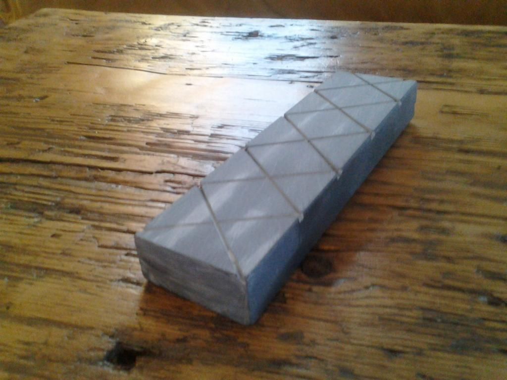

Just some alternative suggestion - the diamond plate is probably a better way to go, I don't use one myself. I took my old Chinese 12k for which I had no use, and hatched it with a diamond sawsall blade. I use this on my waterstones and Jointer stones just the way it is, and if lapping a hard stone like Arkansas, India, silicon carbide, I'll use some 120 grit SiC as a lapping abrasive.
I have also done this treatment to a couple of stones and it does a good job. So far the 12k is holding up very well to this assignment. Is likely a bit slower than the diamond plate but is pretty versatile in that it works great with a slurry.
Increasing the number of hatches would probably speed it up.
