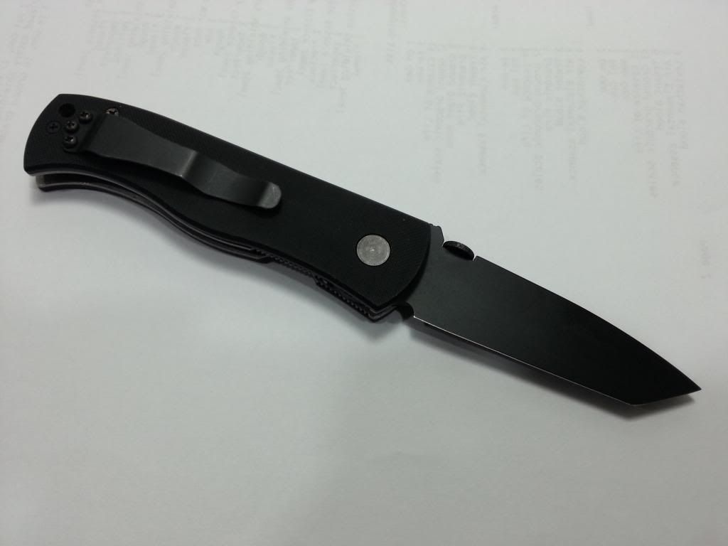

I got both kinds. I like the Chisel grinds a lot but they take getting used to if you're a righty (like the majority) and the V-grinds are weird as they have a chisel edge. I personally like the chisels a bit more. I like the flat side for some reason! Pic to show!

Love that clip! Who makes sit?

Here's another shot for good measure lol
I got the black CF one of the bay and the blue one at a knifemaker site that is in the USA....<--if you catch my drift!
They're cf lamiates though but they're pretty cool, i'd like a green one fo' sho!

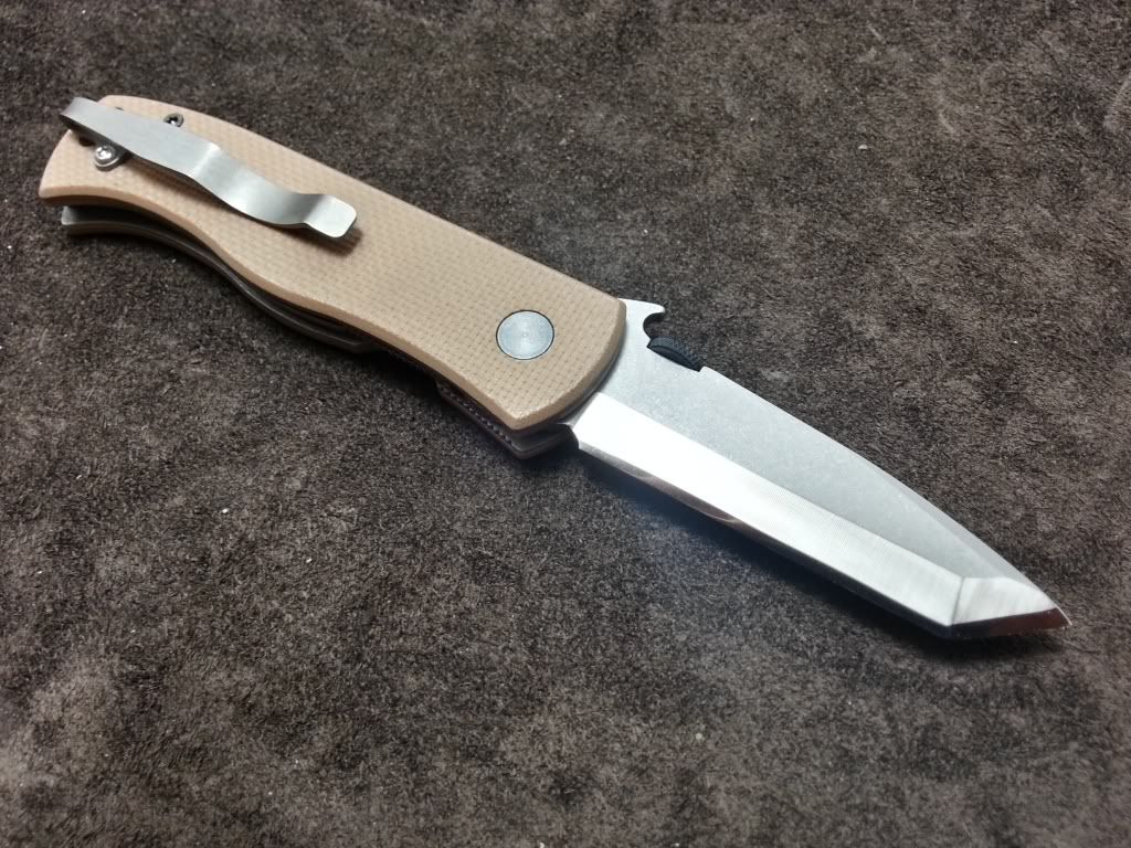

7V. The other side resembles the 7 chisel, but ground at a shallower angle. This is how most other Emersons are ground:
I've since then re-profiled the 7V to 30 degrees inclusive, matching (or tried to) both sides:

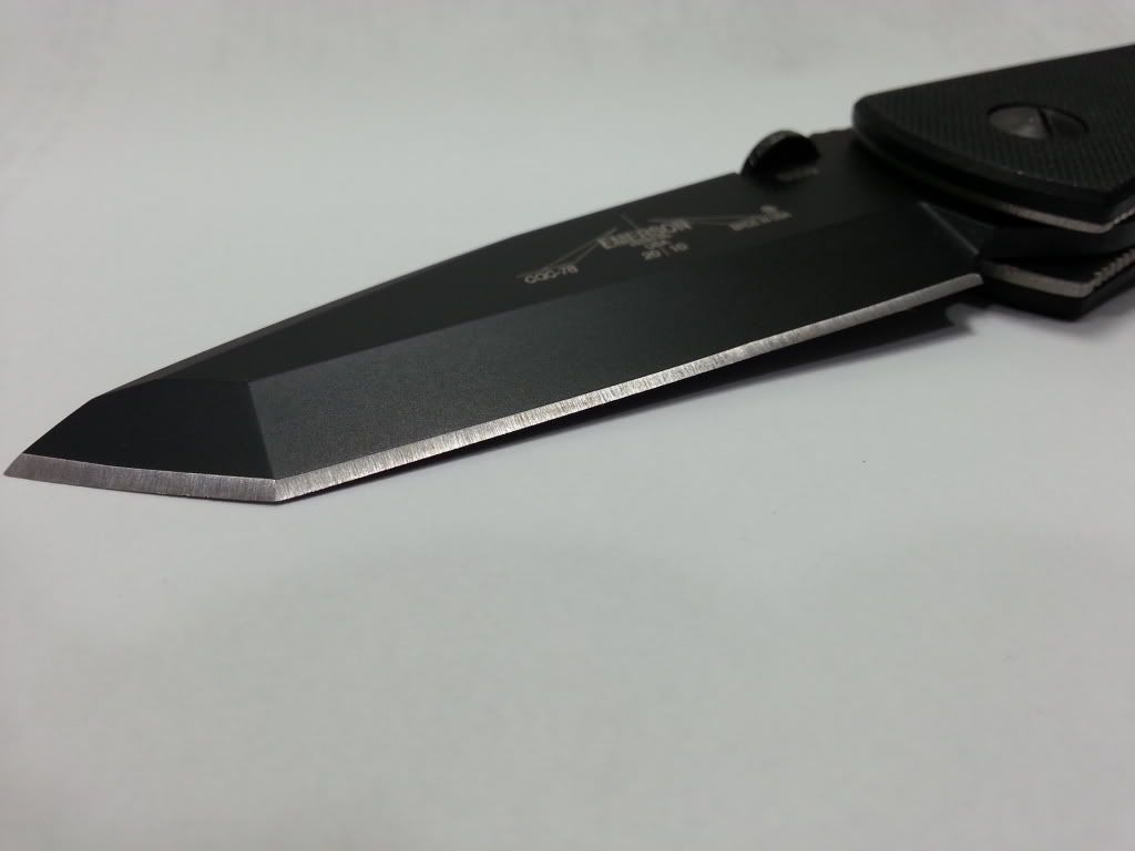

Chisel Edge with Chisel Grind
Back side (No edge)
Centerness lol, all chisels are like that but this is centered. It is a tiny bit to the left but that's because the lockbar is pushing force.
Now a V-Grind Chisel Edge
Back Side (tiny edge that's hard to make out)
Centerness again (little to the right but needs to be tightened), notice the grind has a bevel while the left side doesn't. If you're wanting to convert it to a full v-edge. Your going to have to remove a tad bit of metal in order to get it even such as the example given on Gooeytek's 7V.

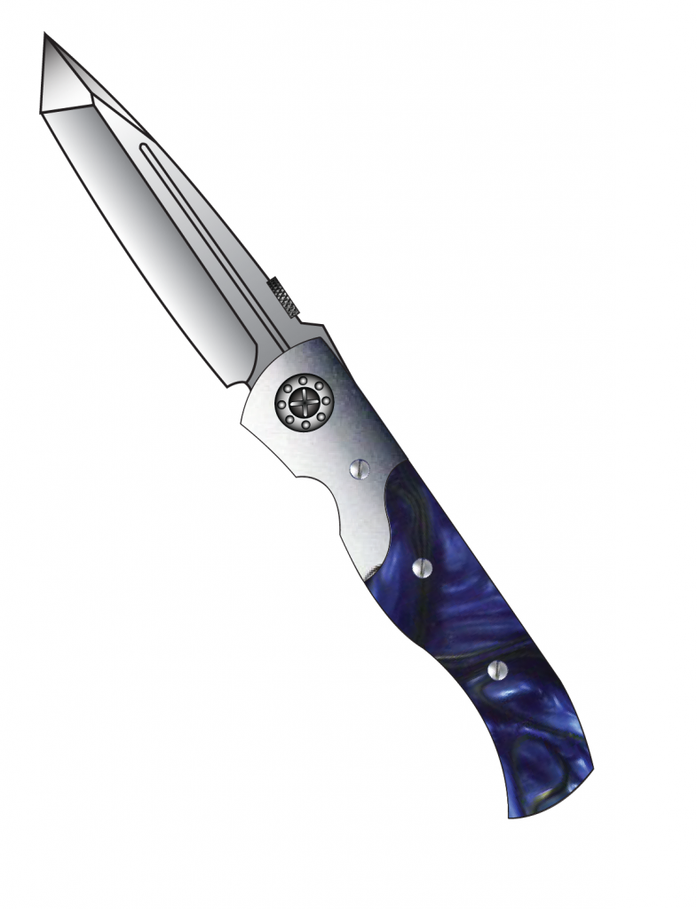

....something like this?
Excuse the additions I've made, they're just some mods I'm planning for my super 7. I added a small belly to it. Nothing major but I think it looks great like that!
