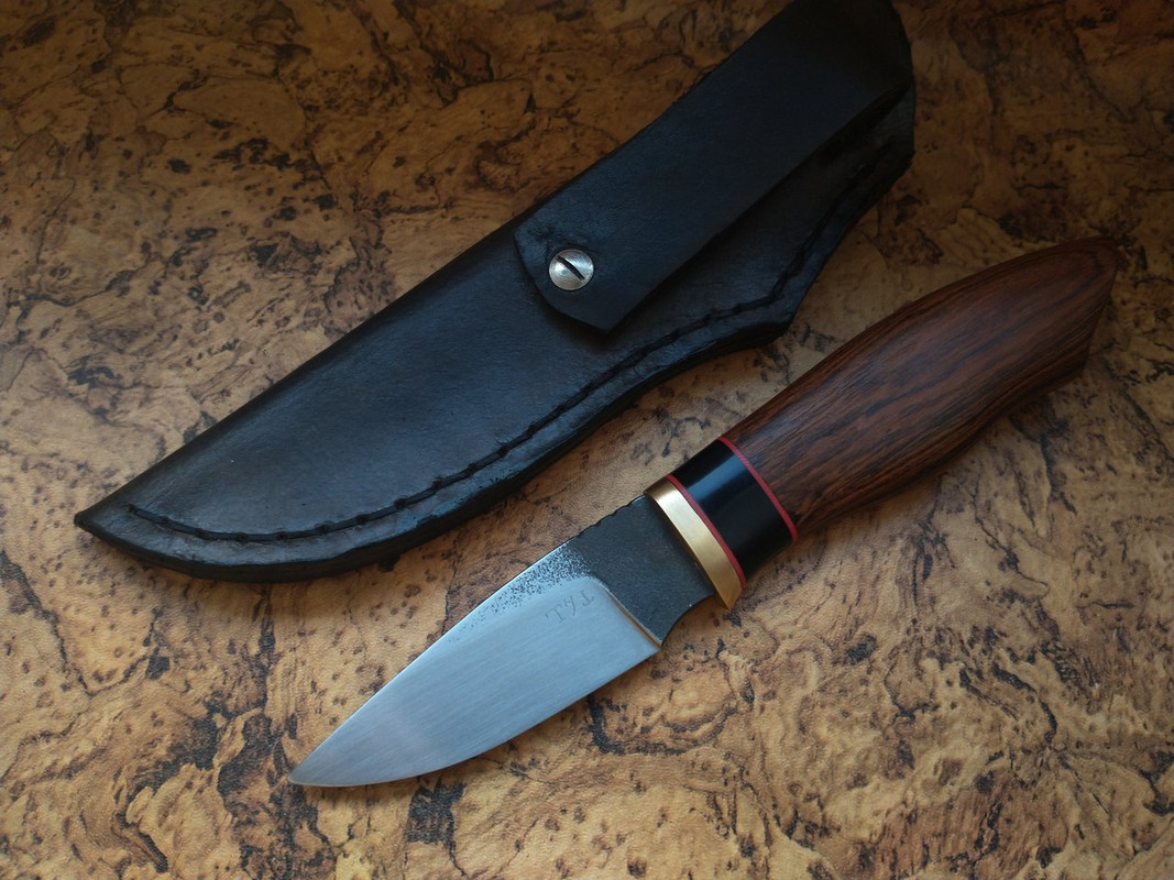

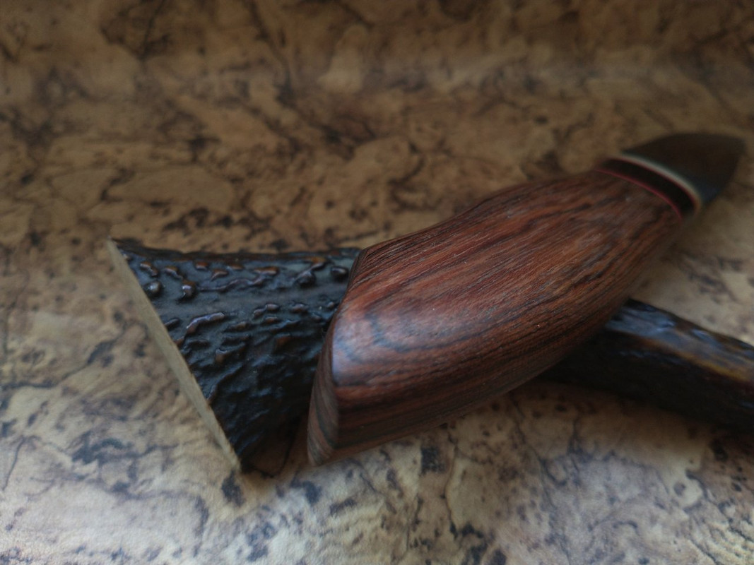

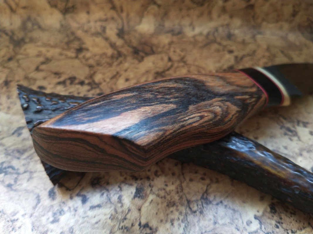

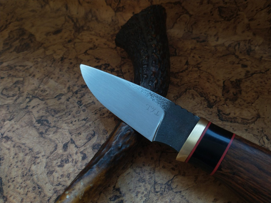

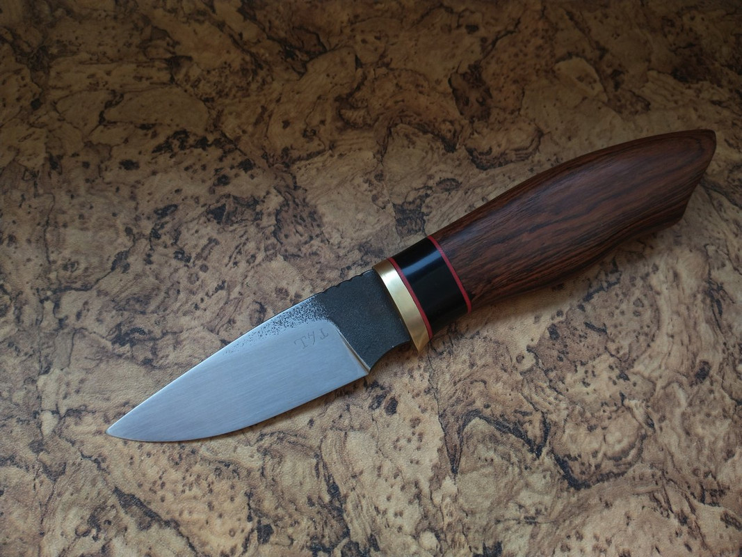

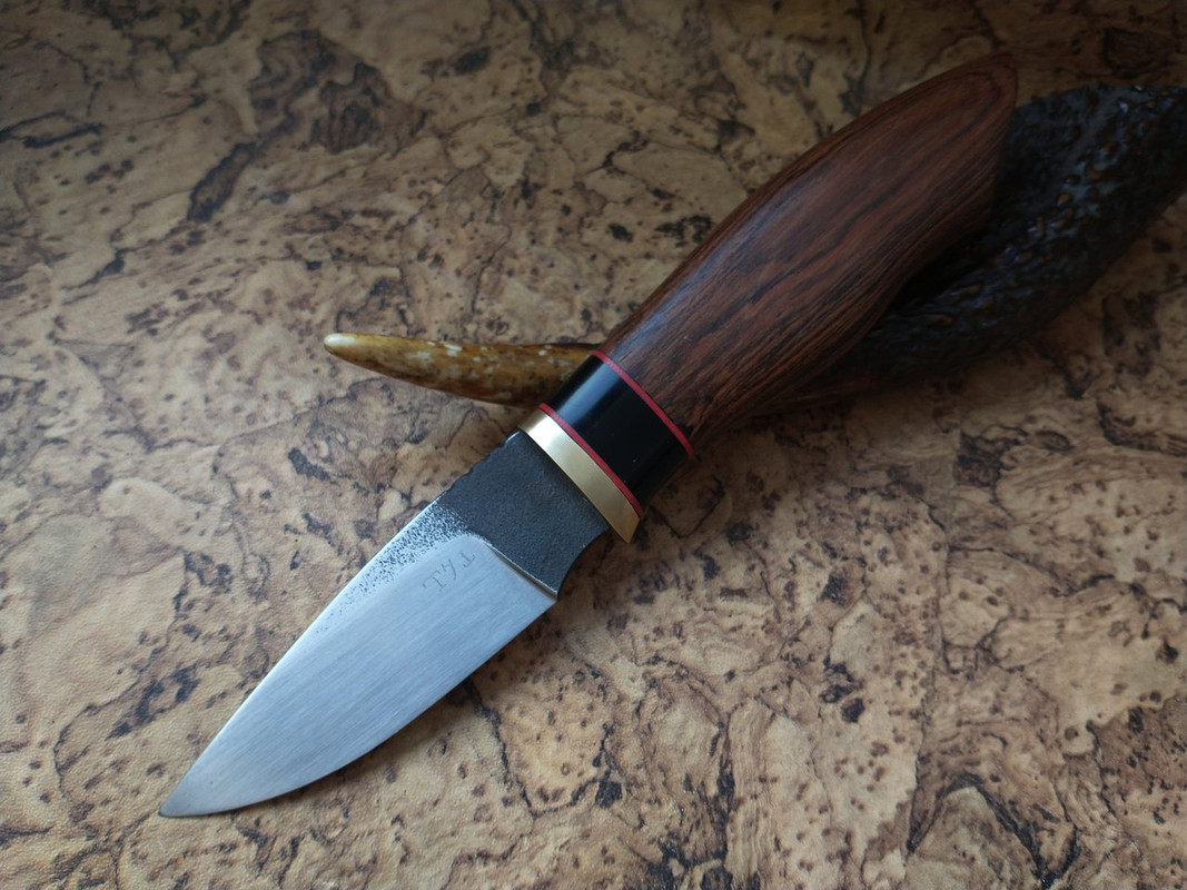

Ashenforge Joined Aug 29, 2015 Messages 71 Feb 26, 2024 #1 Overall length: 7 inches (17cm) Blade: 3.15 in (8cm), 5/32 Materials: brass, D2, cocobolo wood, hanex, The blade is heat-treated in a temperature-controlled kiln. Air hardened in foil. 61HRC. Flat grind, with 30deg secondary

Dawkind Platinum Member Joined Apr 3, 2000 Messages 12,653 Feb 26, 2024 #2 Looks very nice....never go wrong with red liners.
Ashenforge Joined Aug 29, 2015 Messages 71 Feb 26, 2024 #3 Dawkind said: Looks very nice....never go wrong with red liners. Click to expand... Thanks! Black and red never look bad
Sharp & Fiery Leatherworks, Kydex/Holstex/Boltaron, Mods -Canada Moderator Knifemaker / Craftsman / Service Provider Joined May 14, 2012 Messages 9,227 Feb 26, 2024 #4 Classy. I like it!
Crag the Brewer I make Nice, boring knives Knifemaker / Craftsman / Service Provider Joined Oct 18, 2018 Messages 5,562 Feb 26, 2024 #5 Very nice lines. Elegant looking knife.
