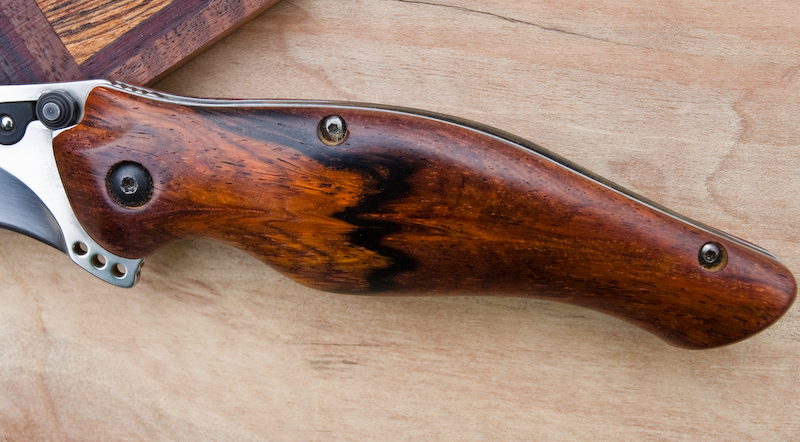

What tools do you use to fashion the scales? power scroll saw maybe? would like to give it a try myself someday. ;)
I don't have a scroll-saw or band saw yet, so I profile differently.
I cut out the blanks on the tablesaw. I use a drill press to drill the holes, countersinks, and to mill out the torsion-bar recess. It's actually possible to use a router bit on the drill press, just crank the speed up to ridiculous; a very solid drill press is your friend here.
I then rough out the profile on a cheap 4x36 belt sander. I finish profiling on an ocillating spindle sander (my fist attempt was profiled by hand with sandpaper). Sculpting is roughed out on the sanders and finished by hand.
Total list of tools:
Tablesaw
Drill press (various bits)
4x36 belt sander
Spindle sander
Lots of sandpaper
Small hand-chisel

Here's the new scale. Now to do the clip side........
Phillip, that is just plain beautiful!!
Awesome job!!
Any new works of art planned?
Again, great job!! :thumbup:
