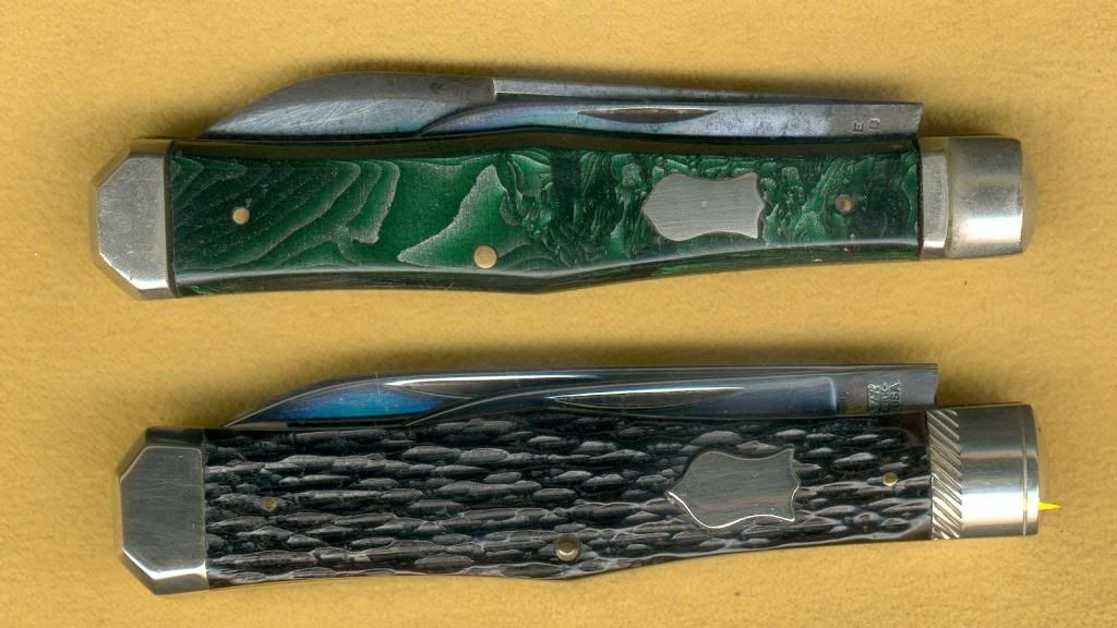

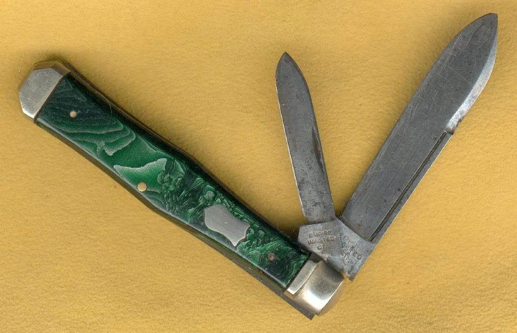

Here's a comparison shot of the Empire, with a "black box" Winchester made by Queen.
Queen didn't carry the beveled cap's (bottom bolster's) bevel into the bone handle, nor to the main bolster. They made the main bolster fancy, and made an interesting knife, but IMO it doesn't have the class and integrity of the old Empire. The Winchester winds up blocky and squared, like many modern knives, and loses its sculptural "flow".
I've been tempted to try and bevel the edges of that knife, but always chicken out :p !
