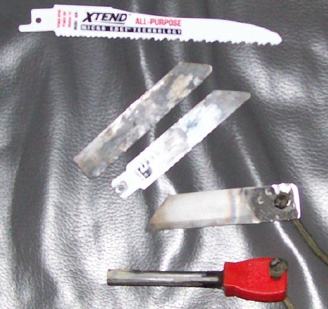

Here are the Scrapers I use...
All of them are made from saw blades of one type or another...
The two in the middle are made from one Sawzall blade cut in half, teeth ground off and squared up on the grinder...
I find these are the best for me, as they fill the hand and scrape off a shower of sparks....

Eric,
Thanks for the sawblade photo! I used handsaw blades. I see yours are from an electric saw? I've noticed that the ones from an electric saw are much less flexible, then from a handsaw. That must be the trick I was missing?
Usually I use the awl or back of my saw in my SAKs.
Again: a picture tells more then 1000 words.....:D
Thanks again!

Yes,, the Sawzall blades are much stiffer than the hacksaw blades.. I find hacksaw blades are a little small for me..Especially when it's cold. If you are forced to work with gloves on,, a hacksaw blade can be a real pain in the ass..
I find the larger saw blade is easier to hang onto and produces a good amount of sparks..
They are a little harder to make, and you have to have a few tools, like a bench grinder, but they are worth the effort....
