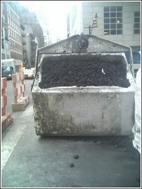

I am asking because at work they burn coke underneath the slab to heat the concrete....and they use alot of it!!
I asked the guy who was loading it what kind of coals they were burning and he said it was coke.Is all coke created equal ?
