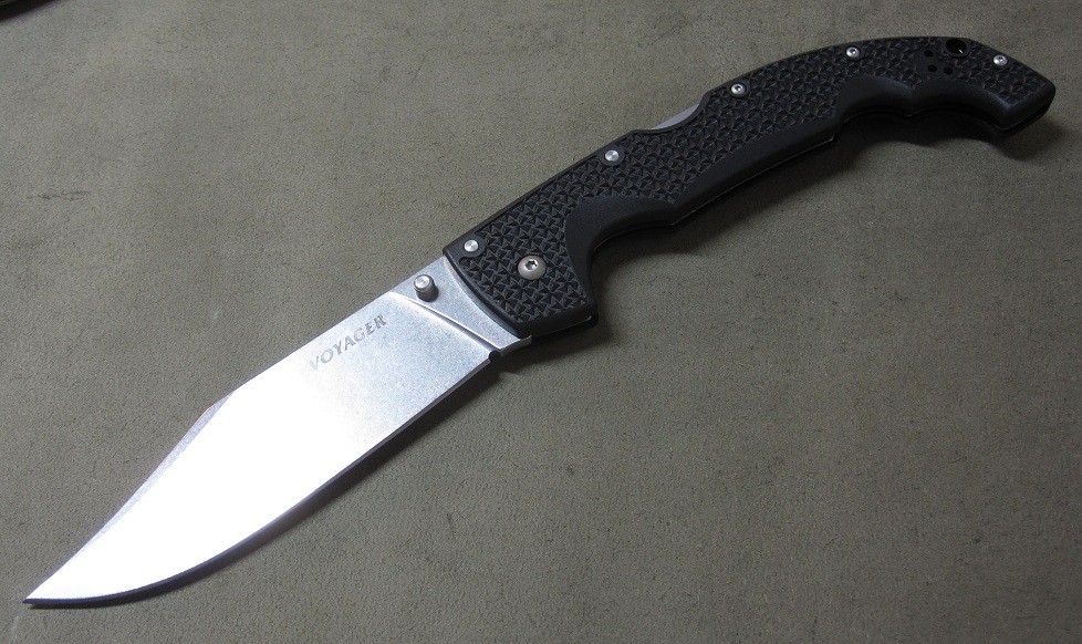

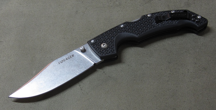

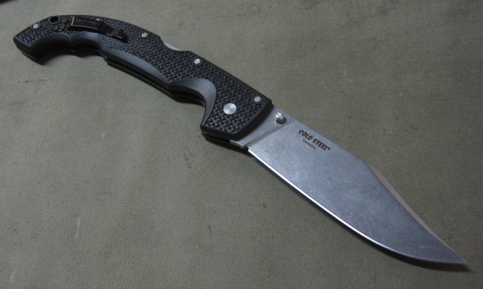

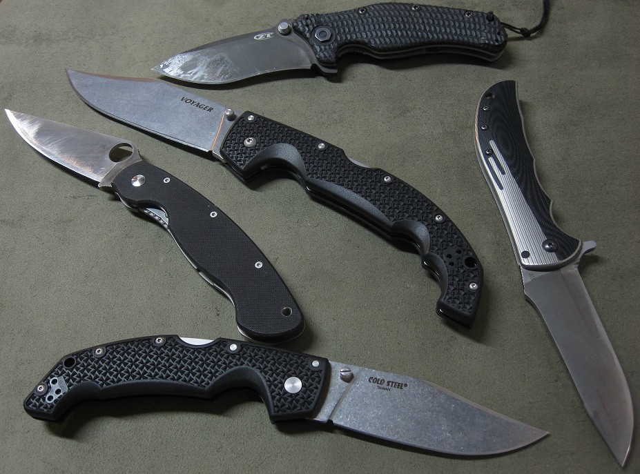

These knives are pretty much everything I expected them to be, that being a pretty big improvement over the last Voyager series.

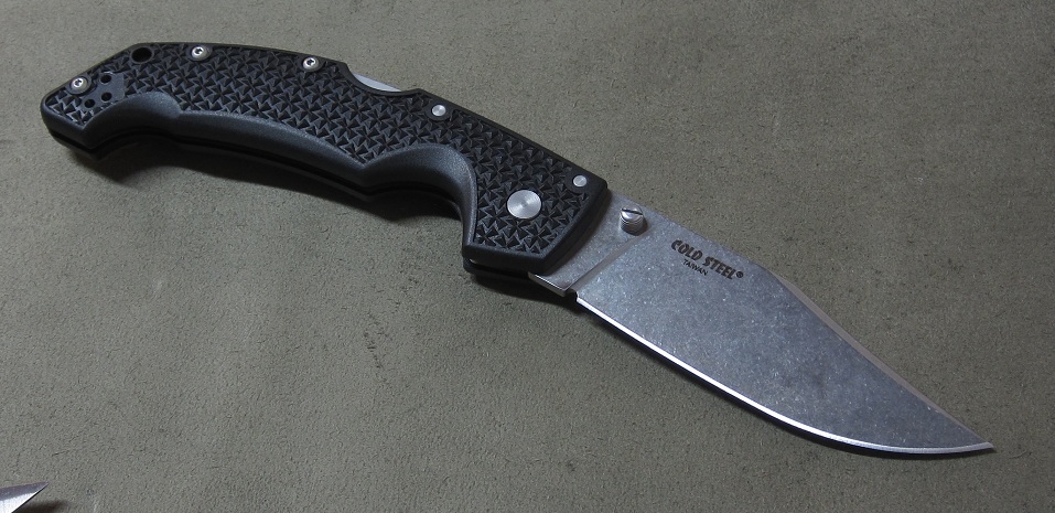

This lock is tight. You get no hint of play in any direction when the Tri-Ad lock is engaged, at the same time there is much less spring tension than you get with regular lockbacks, making it easier to disengage. On top of that it also self adjusts for wear. Barring gross abuse I see no reason why this knife won't lockup just as tight a hundred years from now.
The blade has a full flat grind and a good thin edge on the Large (average thickness on the XL). I'm a little disappointed that they didn't do a distal taper as shown in previews last year, but it is still a very good flat grind so I can't complain too much. The blade is made using AUS-8, nothing high tech, but a good long ways from the bottom of the barrel. The thumbstuds do their job without getting in the way, I still prefer a hole, but at least these aren't a hindrance. The Pivot is buttery smooth while exhibiting no play. Top notch there.

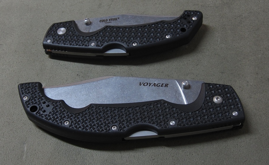

The handle is very secure with no noticeable play or flex. I feel much more confident that I'm not going to slip and cut my own hand using one of these compared with the previous generation Voyager. The texture is very aggressive, I'm sure that if I didn't carve off all the points under the clip it would only be a matter of days before I would have no seam left on my pocket. The clip is nice and minimalist, but very tight. As with nearly all pocket clips I had to re-shape it to get the clip onto a double layered pocket seam. I haven't done any heavy cutting yet so I can't say that the knife doesn't give hot spots, though at the least most pocket clips do, so gloves are recommended for extended cutting sessions. If you don't work with your hands a lot the scale texture might rip your skin off anyway.

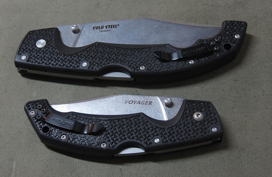

The handle shape on the XL is definitely made for big hands, and the Large (I still want to call it a medium) feels like it's built for more normal size hands. The grip on the XL encourages my fingers to spread out (should be just right with gloves) where the Large is a more snuggly fit, the finger spacing on the Large is just about perfect for my 3.75" palm (measured at the knuckles).
Considering the $40-$50 price tag I think these things are just about as good as they can be.
Now to compare them with my current favorites.

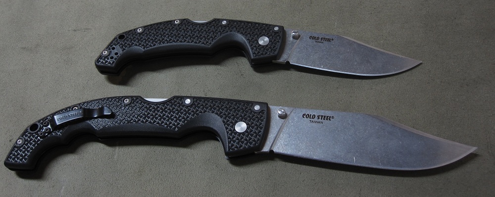

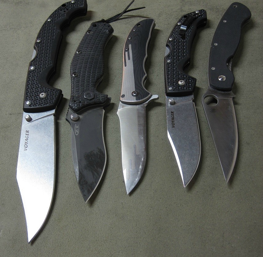

Edge length.
XL Voyager 5.1" ZT0200 4" Volt 3.86" Large Voyager 3.75" Military 3.75" (and the old Voyager X2 was 5.625")
Edge thickness (measured at the corner between the primary and edge bevels, or where that would have been if I didn't grind it off).
XL Voyager .031" ZT0200 .034" Stock Volt .034" (currently .010") Large Voyager .020" Stock Military .024" (currently .010")
Blade thickness.
XL Voyager .150" ZT0200 .157" Volt .157" Large Voyager .137" Military .143"
Stop Pin Thickness.
XL Voyager .175" ZT0200 .156" Volt .150" (with bushing .187") Large Voyager .157" Military .186" (hollow)
Handle length
XL Voyager 7" ZT0200 5.22" Volt 4.87" Large Voyager 5.43" Military 5.5"
Handle thickness (measured at the palm swell)
XL Voyager .66" ZT0200 .73" Volt .536" Large Voyager .64" Military .45"

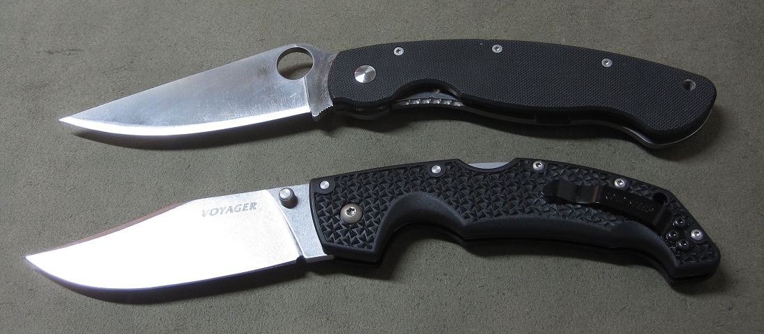

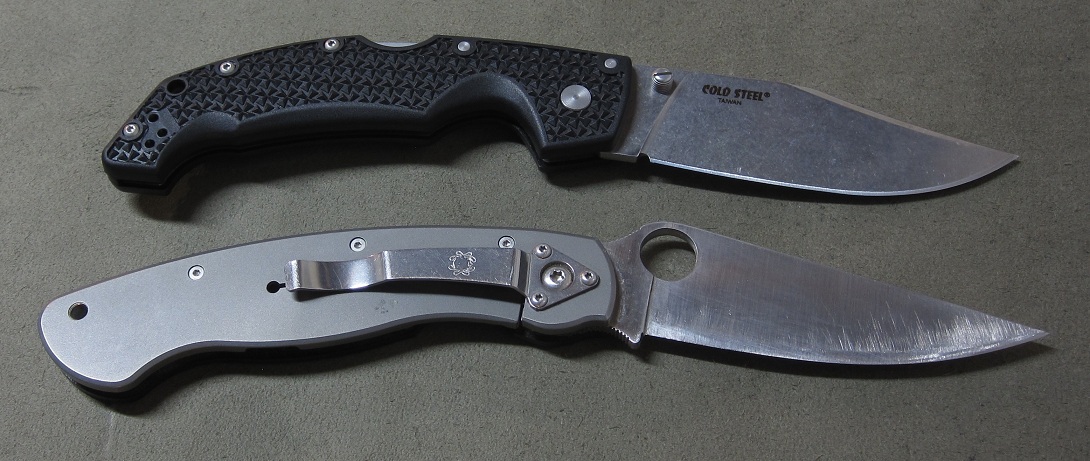

The Large Voyager compared to the Military.
The blade on the Military is still pretty much as good as it gets, the only downside is that if you plunge the blade into cardboard the hole will bind pretty badly, on most knives you snag on the studs but that shouldn't be so much of an issue with the Voyager. If the blade on the Voyager would have had a distal taper I would have called it next to perfect, but it doesn't so that's still a shiny star going to Spyderco.
When holding the knife horizontally both the Large Voyager and the Military angle the blade down below your fingers to make it easy to cut things on a flat surface, the Voyager actually feels like it works a bit better in this regard. I'm pretty sure you can attribute this kind of thinking to Andrew Demko, working closely with him is the best thing Cold Steel has ever done as far as I can tell.
The lock on the Military is about as good as you will ever need, but the Tri-Ad lock is probably better than you will ever need. I like everything overbuilt so that's something I like about the Voyager, the liner lock/R.I.L (framelock) is still much easier to manipulate though.
At the end of the day I will still take the handle shape of the Military over the Large Voyager, the curves of that knife just feel like home after carrying one on and off for about four years now. I specifically like the long handle on the Military and how it gets wider at the butt end, I like having something for my pinky to grip, almost all other knives shrink away there so it makes the Military stand out. The Voyager makes up for it a bit by being really thick, but that doesn't quite compensate enough for my taste.

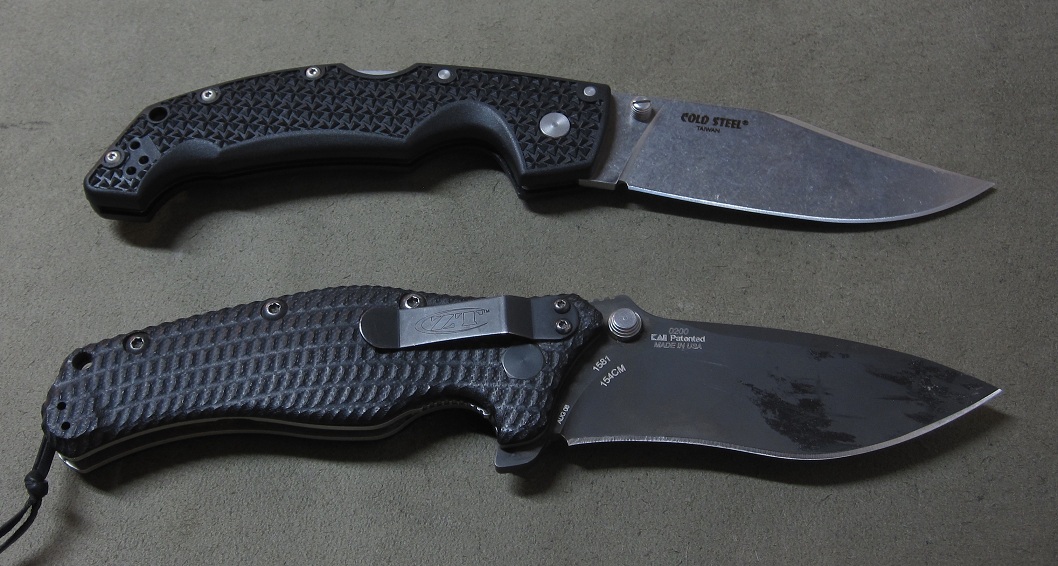

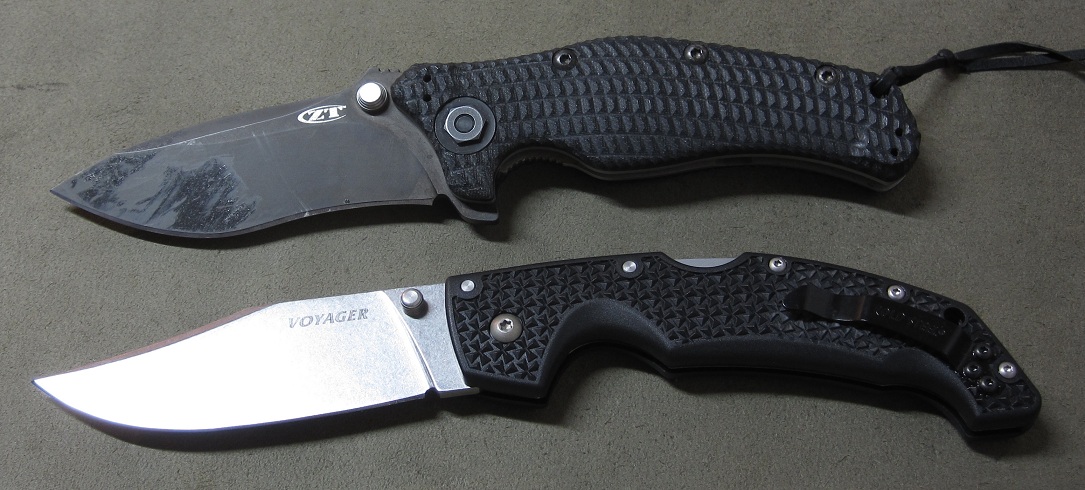

When comparing the Voyager and the ZT0200 the only downside to the ZT0200 is the re-curved blade. I guess if weight savings and the lock are your primary concern then the Voyager would have it beat, I still wouldn't put the super beefy Liner Lock on the 0200 ahead of the Tri-Ad lock for reliability, and especially not for overall strength. Lock performance becomes less important when you have a flipper though. Even if the 0200 fails it would never cut you, your finger is nested deeply in the handle right in the path of the flipper. The blade on the Voyager closes with about half of your finger touching the edge; if, and I do realize this is a pretty unlikely scenario, but if the lock on the Voyager were to fail there's a chance you'd get a good nick out of it.
The build of the ZT0200 is just so solid that it's hard to take the Voyager seriously when comparing them directly, but remembering what knives are made to do you might end up preferring the one that actually does the job better. The grip on the Voyager may not be quite as comfy for my medium large hands, but it is more secure, and the flat spine allows me to choke up on the blade for detail work, where the 0200 is a one shot deal for grip positions (it just happens to get that one shot off perfectly).
I would compare the Voyager with the Volt, but the Volt is so close to perfect it just wouldn't be fair, especially after I reground the blade. (Ok I might sometimes prefer the Voyager since the Volt is a little on the slender side for my tastes, but it's pretty much perfect from a technical point of view.)

Nice review. On a side note, the pic with the 5 vertical knives, which one is that in the center? Very attractive.
