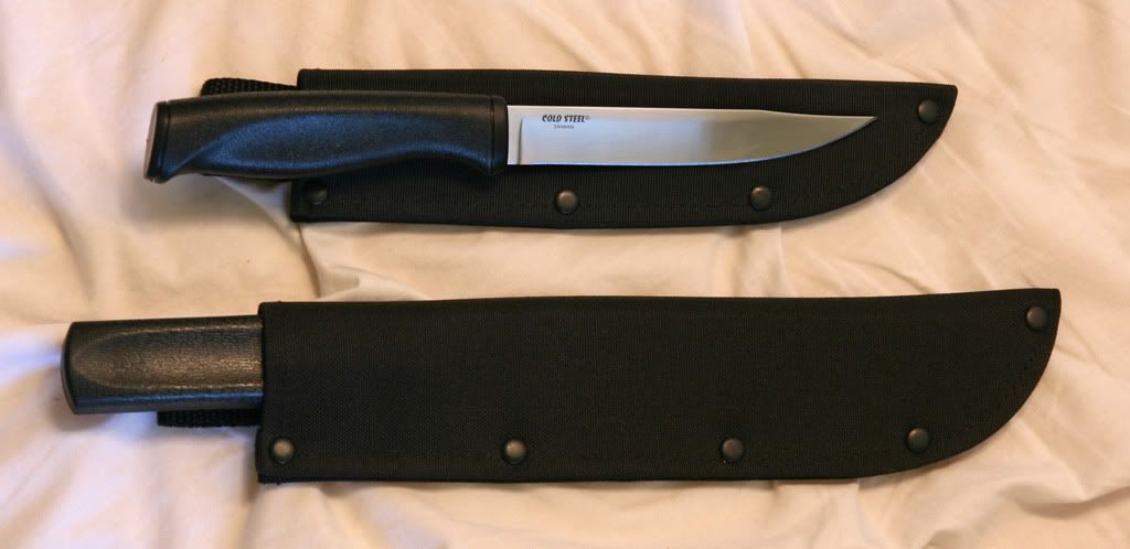

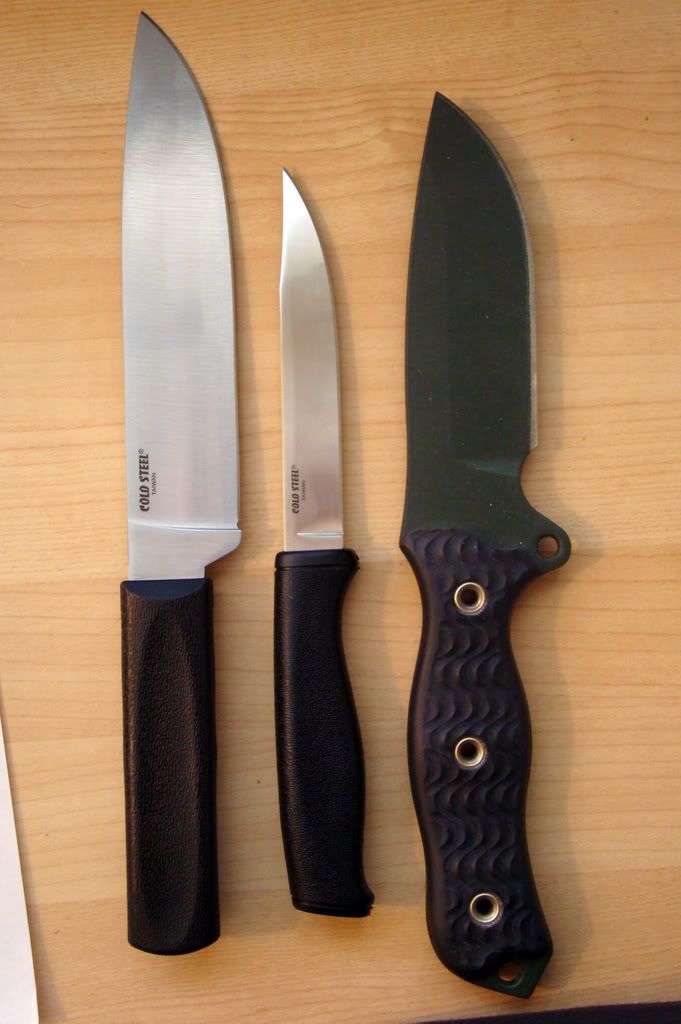

one of the things thats common in a lot of tactical knives these days is the the knife is more then 50% handle, even when it's a large knife. the tiny little finn wolf next to the busse batac actually has almost as much cutting edge, while the long hunter, with the same length from pommel to tip, has way more cutting edge then then batac. the difference in distribution from what I'm used to is refreshing.

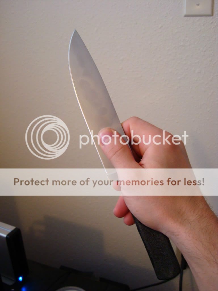

The long hunter feels large in the hand, but only (for me) because I have to be aware of size when using knives round other people, especially fixed blades. as a camp knife, this isn't to large at all, but as a edc user, it's a touch to big. the handle is secure, though it feels like it would be fairly slippery when greased up because of the smooth hard plastic (though there is plenty of texturing). the ricasso serves as a guard, and it does it's job okay.
The blade is 1/8" [edit: 3/32"] thick, all edge, full flat grind and plenty stiff with a thin edge and tip. It reminds me of the wood handled old hickory knives I bought a long time ago attempting to buy a knife of this category, but this one is head and shoulders above them. The edge and tip indexes well when blind, and it looks great. the blade profile and pleasent sheen from the satin finish reminds me of much higher end much more expensive bowie profiles.
The finn wolf has less of a gaurd, feeling as though in a hard stab it would slip backward in the hand, exposing the fingers to the edge. If you grip hard, it feels secure enough, but not so secure that you can forget about edge safety.
This little thing has a LOT of edge, and a very fine tip. it's 1/8" thick, stiff, with a hollow grind. I'm really suprised at how thin the edges are on these. it has the same smooth hard plastic handle material as the long hunter, but with a more contoured shape.

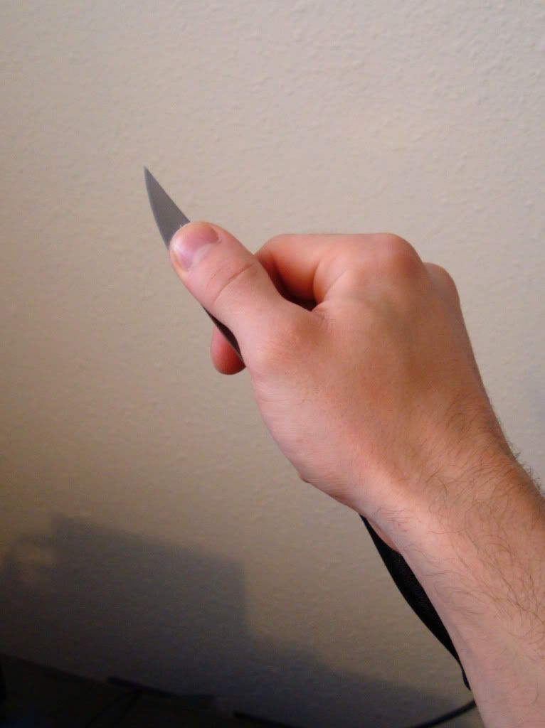

when choking up on the finn wolf you can get a very tight control of a very thin sharp edge, making it good for fine carving and detailed tasks.
food prep position 1, fine chopping/shaving. the long hunter is a bit wide for this, and the finn wolf handles better in this position, but id does well for it's size.
food prep position 2, chocked up chefs knife position. handles like a charm.
the sheaths that come with this are basic canvas pocket stile sheaths, where the edge is kept stable by a strip of rubber at the seem where the two edges of the folded canvas/cardboard (orwhatever it is) meet. I wear fairly tight clothes, a pair of dickies and a plain black shirt, so anywhere where I wear this it shows noticeably, including IWB (which is quite uncomfortable). It wears just fine on the belt, though it's a bit floppy being low ride. if I could wear them on the belt, they would be fine usable sheaths.

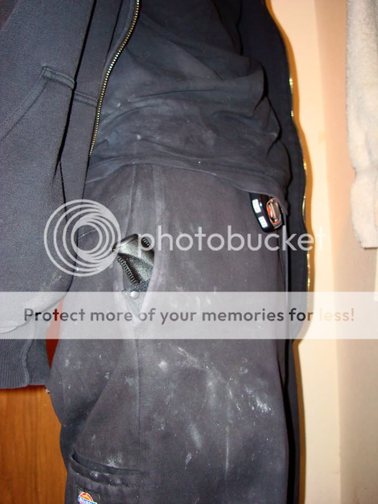

the way I carry the finn wolf is just in a pocket. dickies pockets are quite large, and I can push the finn wolf inward and completely conceal it in pocket.

Could you put a magnet up to the Long Hunter's handle and see how far back the tang goes? I posted pics of my de-handled Finn Bear a while ago, and it only has a little less than 1/2 tang (very similar to Frosts plastic handled Moras). http://www.bladeforums.com/forums/showthread.php?t=534179 On the Bear, this is fine, since it's a small, light-duty knife (and the tang though short is very beefy and well moulded into the handle). On something like the Long Hunter, I'd want something more substantial.
the only magnet I have is the speaker magnet in my fender 112 amp, and that indicates that it0 stops 1/2 way down the handle. theres definitely nothing past the 1/2 way point, and I would assume that it's construction is very similar to the fin bears. Since my copy has the handle slightly farther down on the tang, I have even less handle molded around the tang then usual/whats meant to be there.
It seems that if you were to use the long hunter for more stressful tasks like batoning, the likely damages incurred on the handle would be an overall loosening, rather then an outright failure (as long as the tang looks like the one on the finn bear). and if the handle did break, having the 2 holes pre-drilled would make it a little easier to rehandle in a 2 slab method, and would make it equally secure in a redone hidden tang epoxy filled type handle.

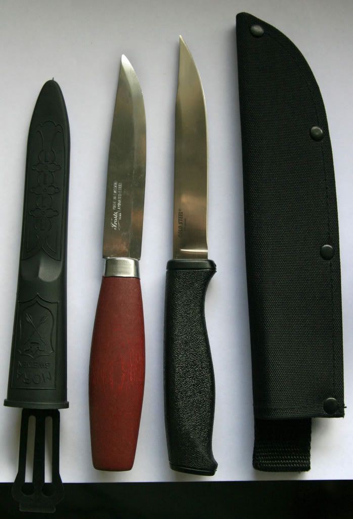

mora vs. finn wolf:

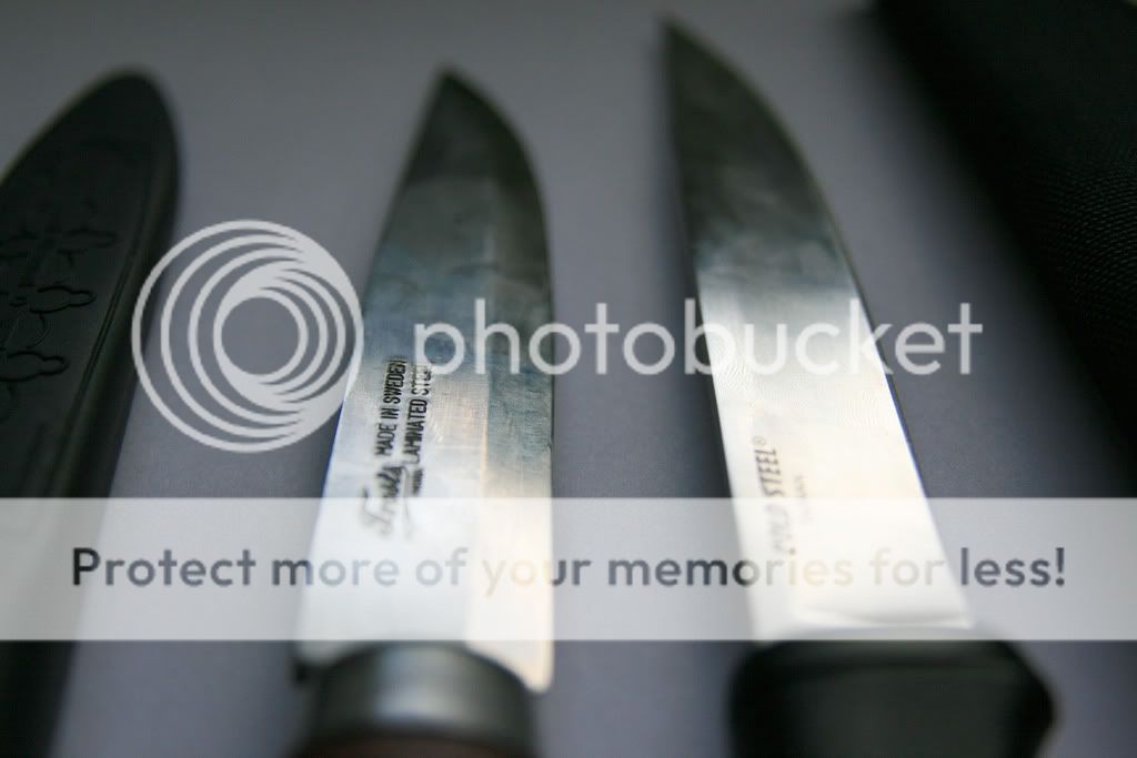

overal size is about the same. the mora feels much more substantial in the hand, do directly to the type of geometry the mora has wich has more full spine thickness throughout the blade.

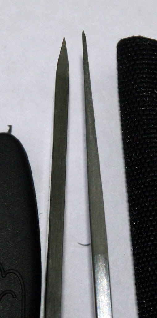

The main reason I don't like mora's - any of them. because of their "scandanavian" style grind. This low flat saber grind is made less obtuse by it's zero edge, but to me its still thick.
To give you an idea of how this grind translates into cutting edge - heres a pic of the difference between tips, and effectively the difference between grinds. The cold steel is waay more accute across the entire blade in overal geometry, even though the mora might have a slight edge 1/32" from the actual cutting edge.
The mora is also lower on fit and finish. I got this from ragweed forge, wich is a great seller run by a great guy, so I have no doubt that this came from the factory like this. there is a section of edge in the belly of the blade that is rippled, and the flats dented, as well as the tip being blunted. It's surpising to see the edge rippled given the rc of 61-62, but it echoes cliffs review of the laminate version of mora's carbon steel.
They say that the laminate version is considerably more flexible then the straight carbon version, but I don't see how anyone could call this flexible. the cold steel is more flexible (and the cs is pretty stiff) because of it's geometry, but both require a good amount of hand/forearm power to bend noticably.
I like the mora better in pocket then the cold steel, because the streamline sheath makes it a much smaller overall package, but for the geometry alone (And the lack of gaurd on the mora), I'd choose the cs any day of the week. Wether the steel will hold up to use is still questionable, but everything else about the knife puts cs ahead of mora for me. the mora is a beater, the cs is a slicer.
I got this particular mora (s-1) thinking that the higher rc laminate blade would be tougher and stronger then the normal straight carbon versions, but after reading cliffs review of one I immediately sent an email to ragnar asking to have my order changed, but apparently it didn't get sent through or substitutions like that are a hassle for him. so I bought another one, the 612, wich is the standard carbon steel, with a single finger gaurd. I think that I will like that version MUCH better then this one, because the lack of a guard (and the inherently distrust of the steel given it's rippling, and past reviews) will be addressed with the new blade.

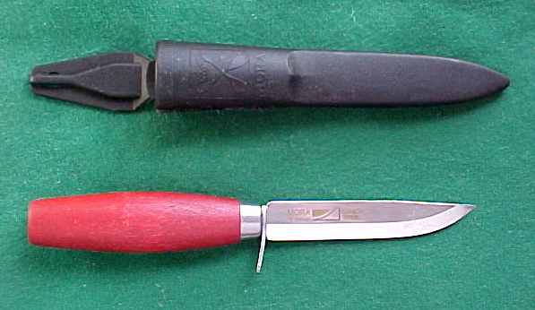

this is the one I'll hopefully get on monday or tuesday -
Funny, the reason you don't like Moras is the reason I like them- I like Scandi grinds.
I haven't bought a Mora like yours pictured because of the lack of a guard, as well. My Mora, the Swedish Army Knife, has a pretty good guard.
