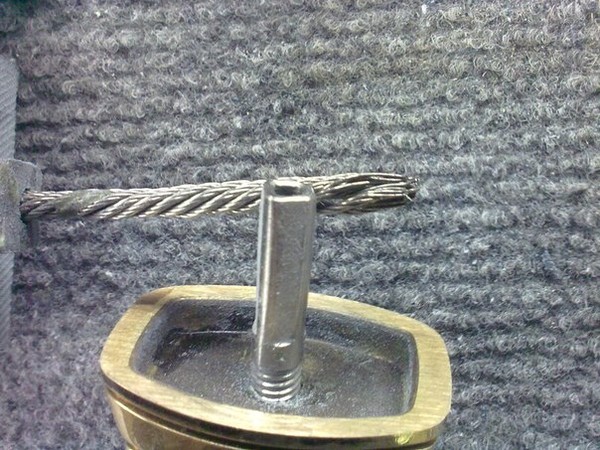

I saw this on the cold steel forums "The SK-5 Laredo bowie is made using cable full tang, but as for the San Mai III Laredo bowie, it follows the same construction, but instead of cable a solid rod is used."
Can any of you guys verify this?
I have the San Mai III Laredo Bowie, and I'm interested in what type of tang my knife has. - I know the SK5 version has a wire tang, but I'm not sure if the San Mai III has a different type.
It would be awesome if somebody could x-ray the knife if possible; to see the exact tang construction. (destroying the handle on a knife like that is a waste)
Thanks guys
-b4b
SMIII bowie has about 2.5" of tang that is the back end of the blade, and then a steel rod fastened from there that runs to the pommel.

This is an economical solution of shorter stock ,and the cable just work as glue and rivets.
more wider and longer of a tang will make blade more stronger, no mater what you said about your positve expriences on your cable tang knives.

a rat tail can make it differ, or worse?
why in old days there are few things with cable tang ?
katana and dadao made and use for fighting , why those things not ues cables on ?

my Qs there are that the cable tang design is the only way to make fighters? and RAT TAIL tang is worse or lower grade than cable tang ?:D
my conclusion here is the cable tang is not a good way to make knives , even figher , this is a faster and cheaper way to make knife , cause if use rattail on knife will consuming more manpower .
