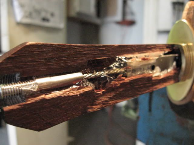

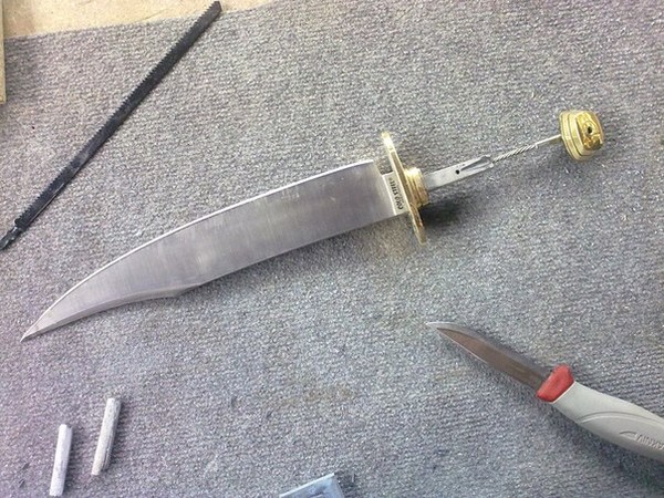

my conclusion here is the cable tang is not a good way to make knives , even figher , this is a faster and cheaper way to make knife , cause if use rattail on knife will consuming more manpower .
Do you have any idea about production methods? Full tang or rat tail is much less labour intensive than putting a cable between the tang and the pommel.

as one of random individual , i think cable tang is an easy way to fasten the pommel and let the un-trained men to work well . and also let the handle and pomel looks cool and neat.
FOR getting good lookings Sacrificed strengh , and this is what your long history of making knives CS have did.

"the cable adds to the combat ability of their knives" a kind of Superstition i think.hey , how about throw them against trees ?
if your combat knife shattered like that , how about the ability of combat left ? and do you know which cable tang knife served in army ?

The cable tang shouldn't break under normal utility use. The whole argument that it wasn't durable came because some guy was hitting the wooden handle itself to baton. Course it broke. I've done chopping with a Laredo Howie and it never broke. Hitting handles is a dumb idea.

The justification Cold Steel use for their cable tangs, which are more difficult to assemble than a rattail tang, is that they lighten the handle, moving the balance of the blade to make it more lively in the hand, and they absorb shock in blade on blade fighting.
They are designated as "fighting" knives, which is to say they are designed for the kind of blade on blade combat that nobody engages in anymore. They are not throwing knives, they are not bushcraft knives, they are certainly not designed to be hammered into a log like a nail. Cold Steel are quite clear that if you want to do those things you should buy their throwing knives or a Trailmaster.
