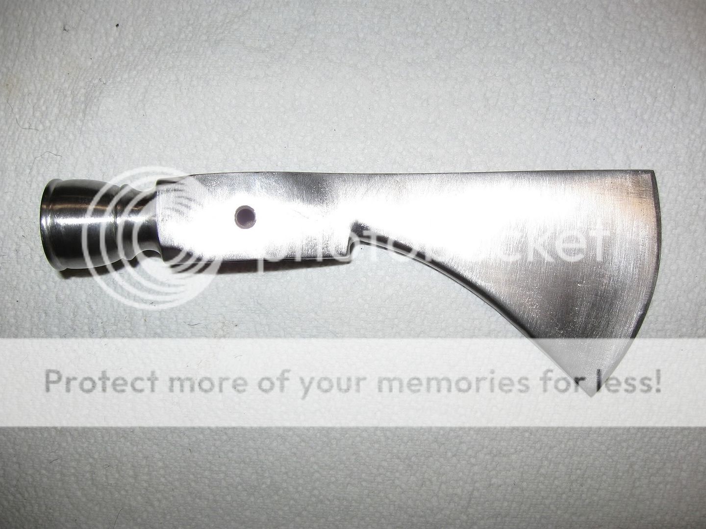

My first post here :) Below is a pictorial tutorial on how I turned my $28 taiwanese drop-forged Cold Steel 'pipe hawk' into a smokeable, traditional looking hawk to rival hand-forged hawks costing 10x more.

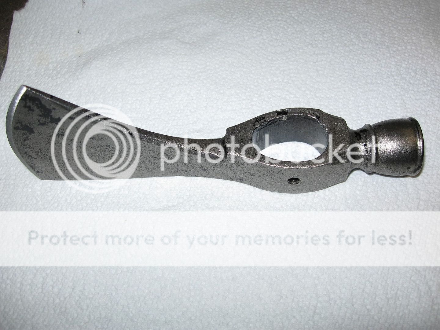

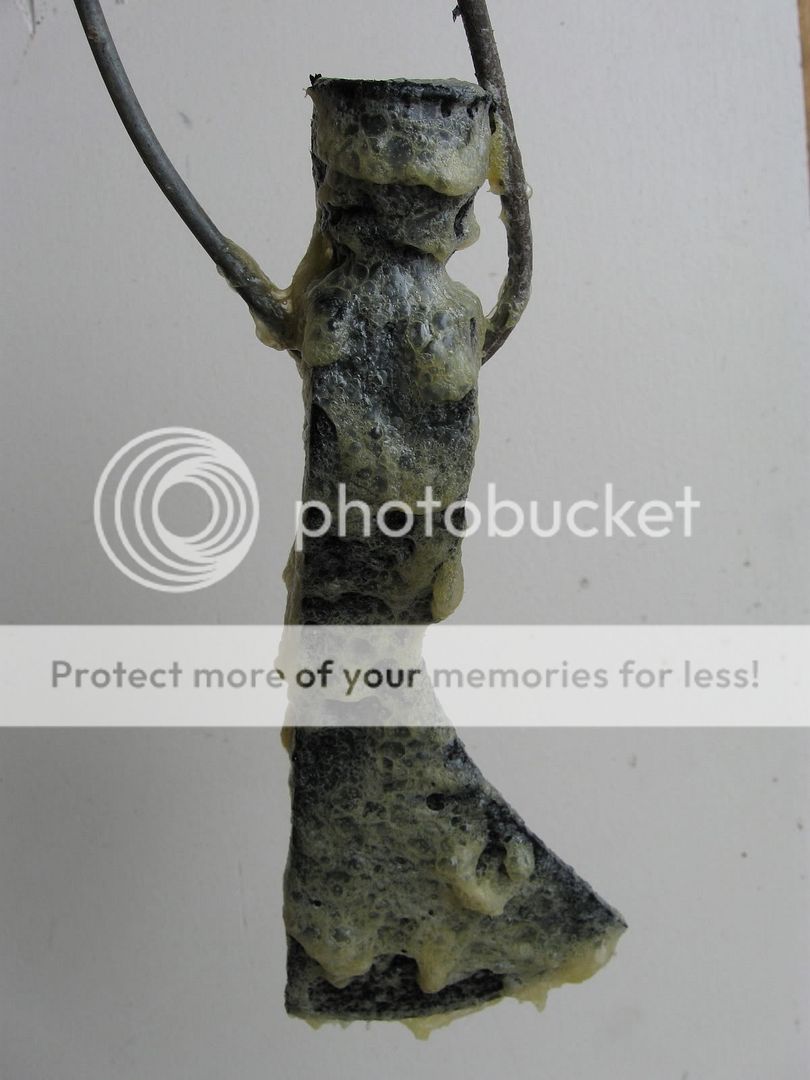

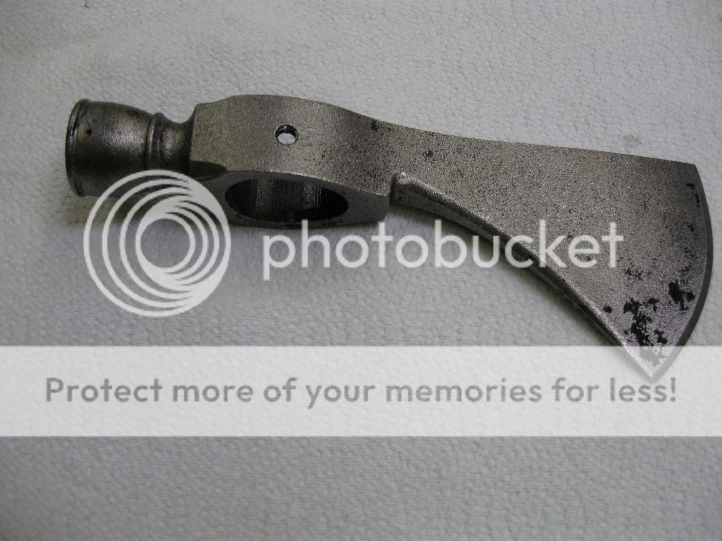

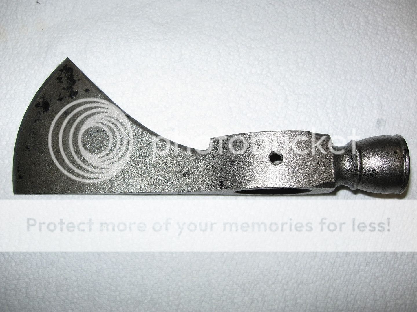

First, I used paint stripper to strip off all the ugly black paint:
Which revealed a very rough, uneven and unfinished texture:

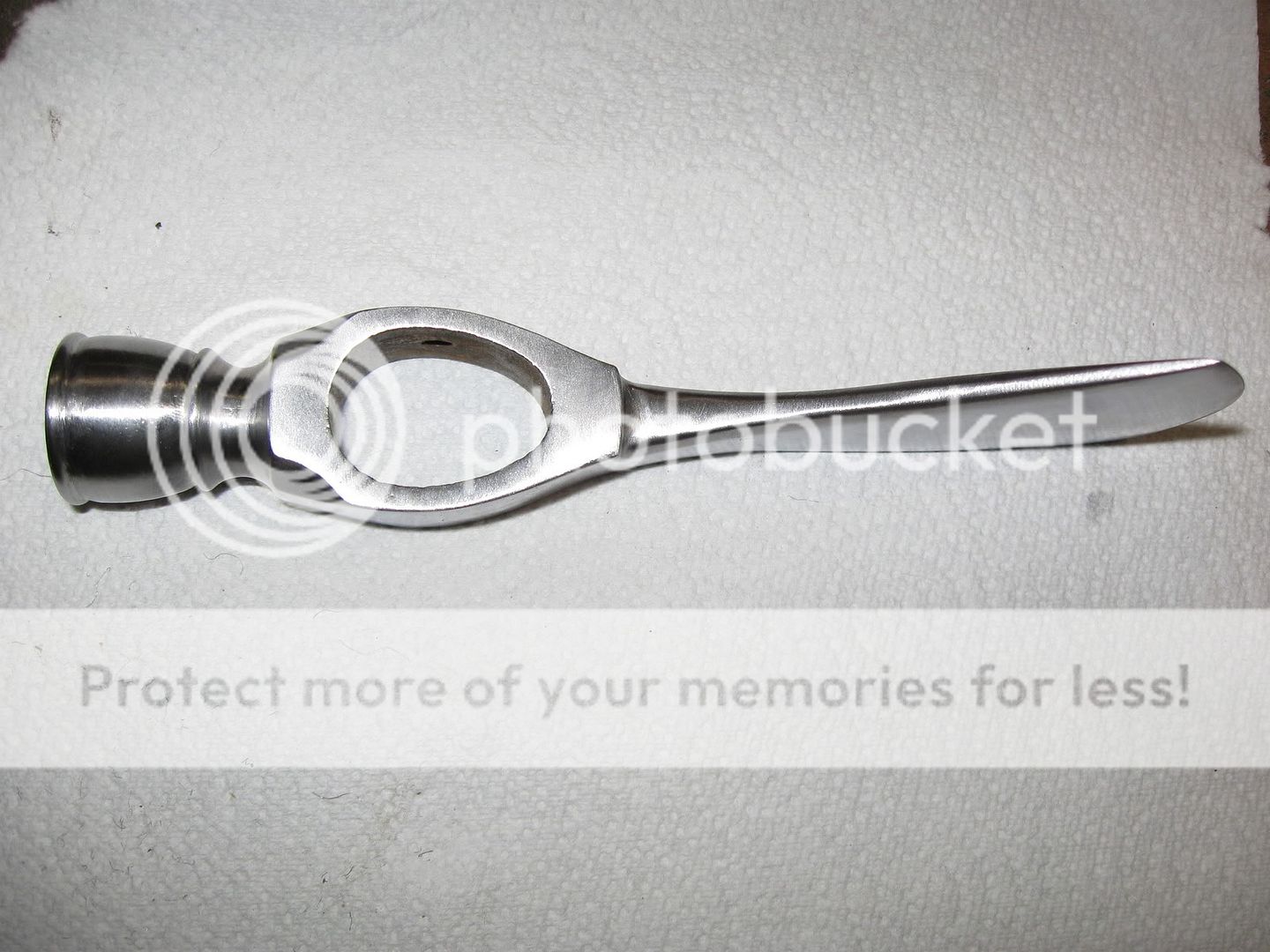

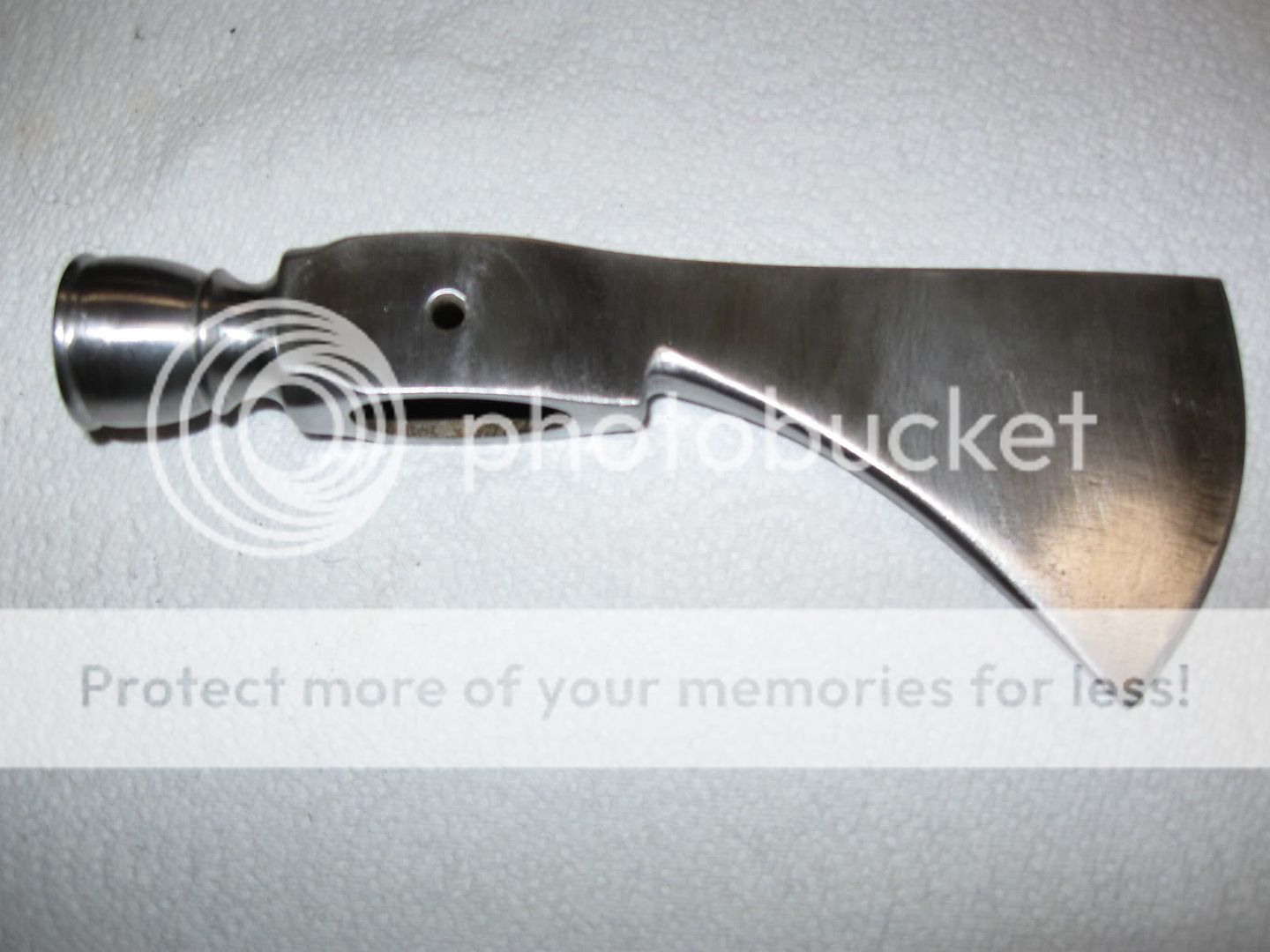

I then used an angle-grinder with an 80 grit sanding disc followed by a paint-removing wheel to smooth out the finish and some of the uneven areas from the forging process:

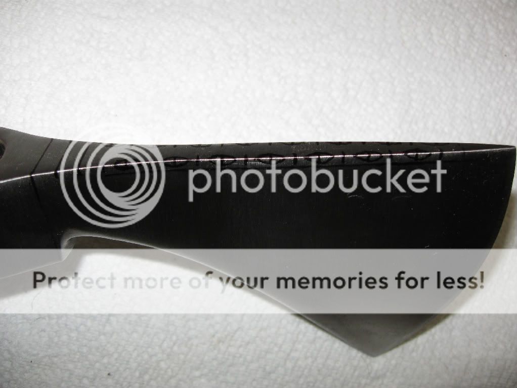

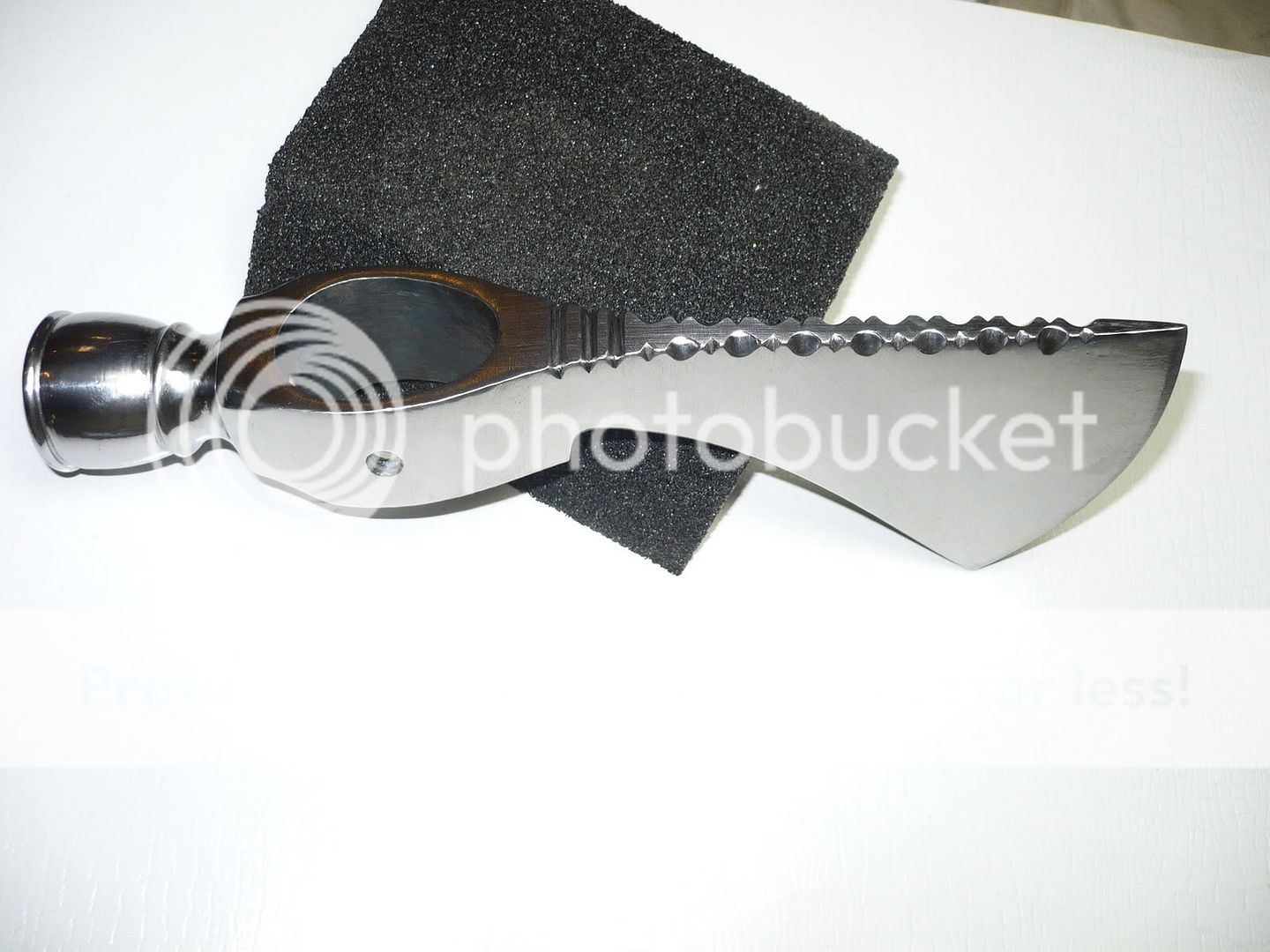

I then laid out the pattern for the filework with a sharpie:

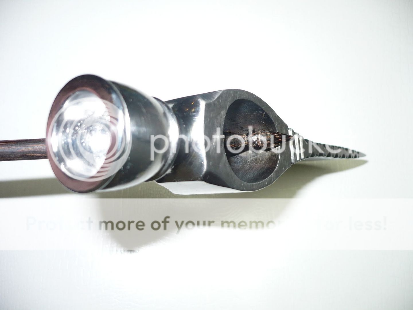

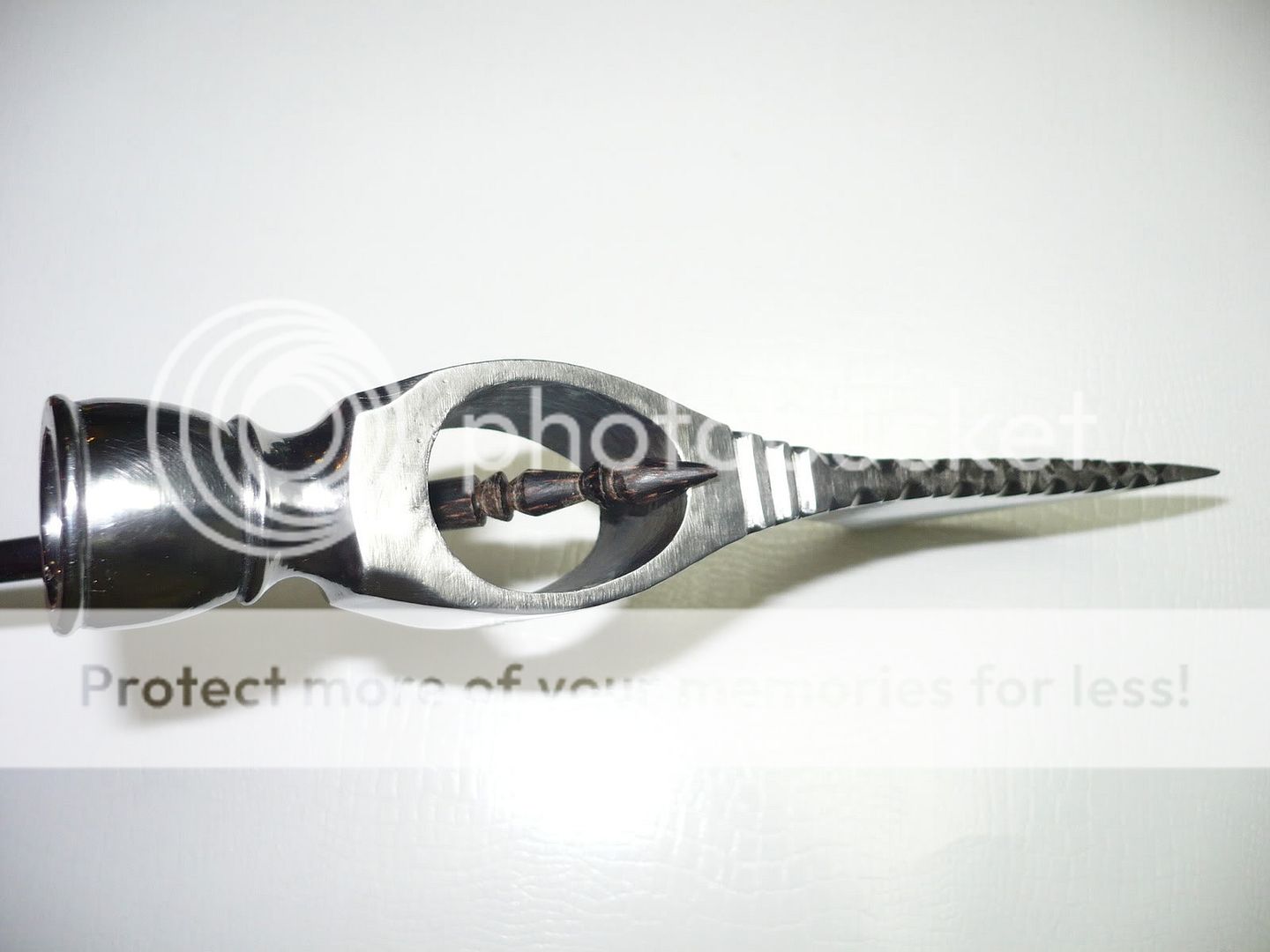

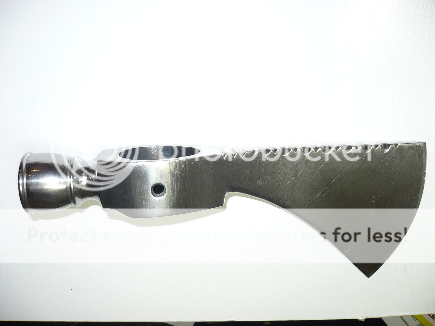

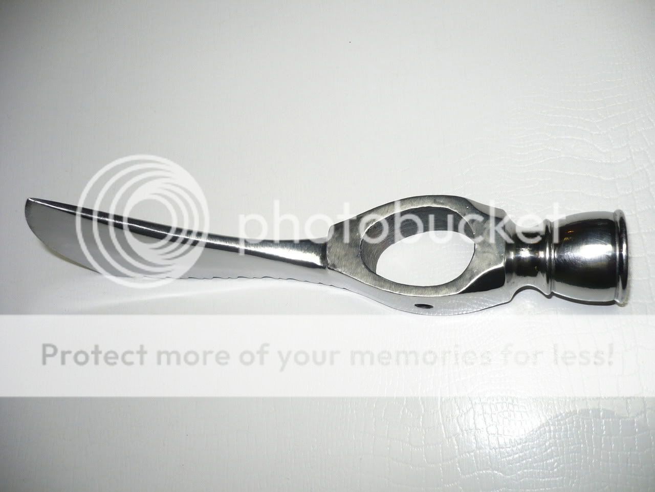

I cheated by cutting out most of the filework with a dremel cutoff wheel, then I did the finish work with round and 90 degree files. I had to anneal the pipe head to make it soft enough to drill out - I step drilled it on a drill press. Unfortunately I broke off a 1/8" bit right as it drilled through, which took me about an hour using several punches to drift it out. I then polished the hawk using a dremel polishing wheel, followed by steel wool w/flitz polish and finally a rag w/flitz. Here is the finished product:
All that is left to do on the head is to weld-in the set screw hole. I plan to force a patina on the carbon steel, then fit a pre-drilled curly maple handle from RE davis: http://www.redaviscompany.com/0310.html
I haven't decided if I want to do silver wire inlay (which I've done before) or if I should try my hand at pewter inlay. The pewter would be cheaper.
Nice work, did you re heat treat the head?

I only annealed the bowl, so the heat treat on the blade should remain - the blade was buried in ice-sand while I heated th bowl cherry red, then let it cool slowly in hot sand - I'm sure the blade never got above ~350 F.

Update: I had a friend weld in the set-screw hole and finished polishing the head last night. I'll be forcing a dark patina w/hot vinegar tonight and I'll post pics later.
For the handle: I purchased a curly maple drilled handle from Dunlap Woodcrafts which I fitted to the handle (very painstaking - used an inletting compound and gradually scraped down the high spots with a furniture scraper). I'm working on laying out a pattern for pewter inlay on the handle and then to the staining and oil finish. I'll post pics along the way of the handle progress as well, though this will probably take a long time as I'm rather busy lately.
