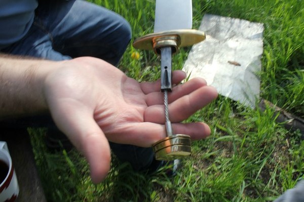

Don't! It's a cable tang - i.e. the blade stops at the guard and the handle is held on by a piece of tensioned wire that runs through it. The Natchez is designed as a historically accurate (in terms of weight and handling if not materials) fighter and nothing else.
This is what a Natchez used for splitting and chopping usually looks like:

You're right that it's designed to be a fighting knife and nothing else. You're wrong about that picture.
The cable tang is designed to absorb shock. That handle broke not because of the tang, but because the owner of the knife was literally hammering on the handle like a baboon. That's part of why I think pictures of broken knives are so stupid. They don't tell the whole story, and then thick-headed people look at it and think "wow, that knife broke, it must suck".
