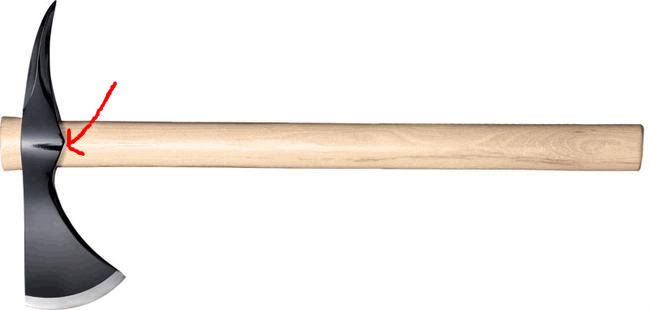

I also forgot to point out a subtle design change. Notice the small curve on the head (near the middle) in all of the advertisement photos?
csstoreonline_2111_1238572
Well, it's not on the production version...
If it matters to anybody...
Thanks for the pics.
The CS pic have had a bunch of photoshop...hell they even have the same handle on both 'hawks.

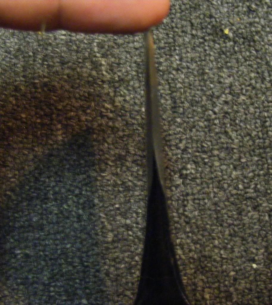

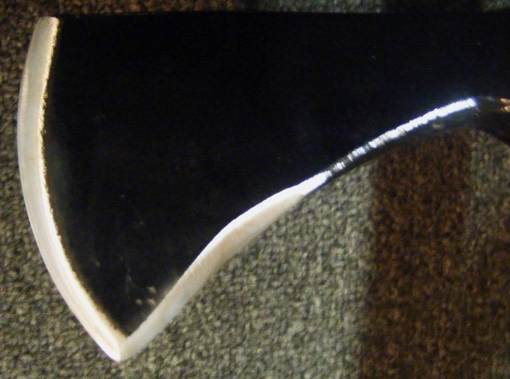

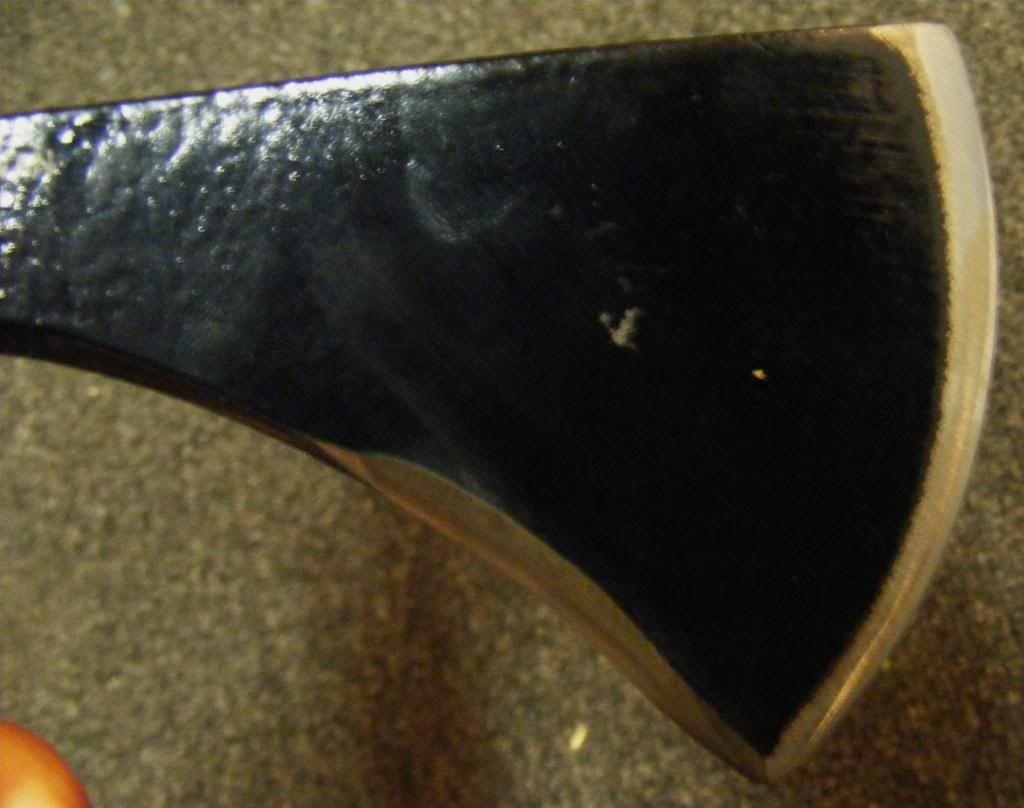

To make the Spike Hawk more tacti-cool, I ground and sharpened the underside of the cutting edge. This gives it a nice can opener effect.
The sides are a tad uneven, but I'm not finished with it yet...

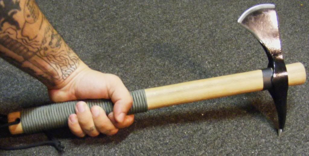

In hand...
The underside, as viewed from the handle. My finger indicates where the point is made where the underside starts and the primary edge begins...

I used a bastard file, then a diamond stone, then a ceramic stick. You could use a belt sander if you wanted to make it quick while still not ruining the temper, but I think doing it by hand gives me more control over the angle.
