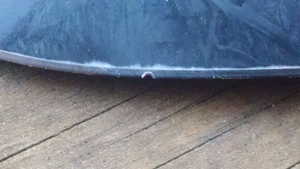

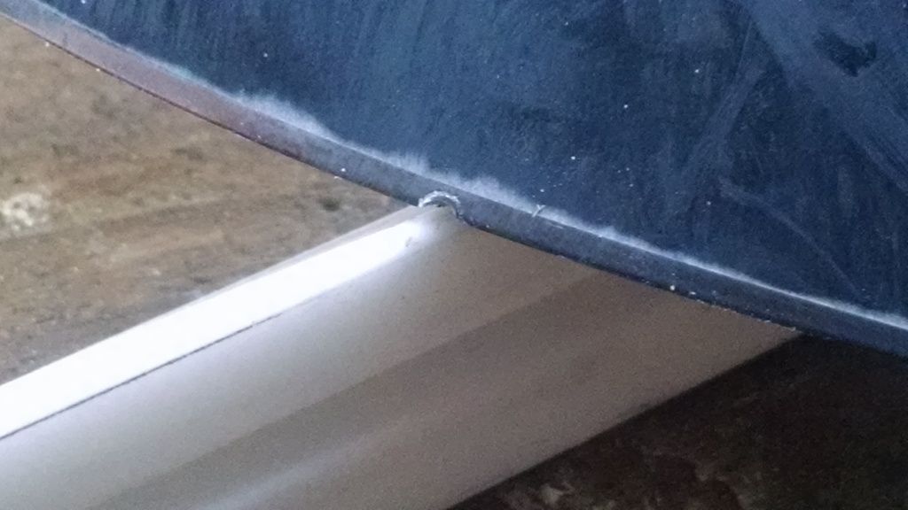

I went full retard,
I whacked a Spyderco Sharpmaker ceramic rod on the pointy side of the stone very hard, choked back on the handle.
It made a big roll.
VG-1 is tough
Do not use the knife to 'chop', or bang on. As this is NOT what a knife was generally designed for. Then...no problem!
